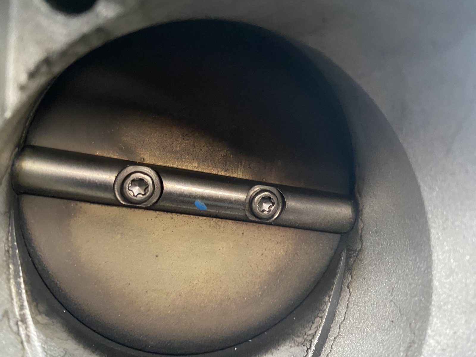

I‘ll also clean the throttle body and mass airflow sensor today, as my symptoms all seem to match up with the symptoms of these components being full of dirt.

Update: cleaning the throttle body and the mass airflow sensor seemed to have worked. Truck idles very smooth and seems to have more power than ever before. It won‘t stall anymore.
Throttle body was kinda dirty, the mass airflow sensor also had a little bit of dirt on it, but not that much.

I hate surprises and I go thru a list of things I do when the oil gets changed. I check and clean the throttle bore, MAF and MAP sensors, rotate tires/check air pressure and check brakes, check and replace air filter as needed. Check all fluid levels and consistency, check belts and hoses. Etc.
