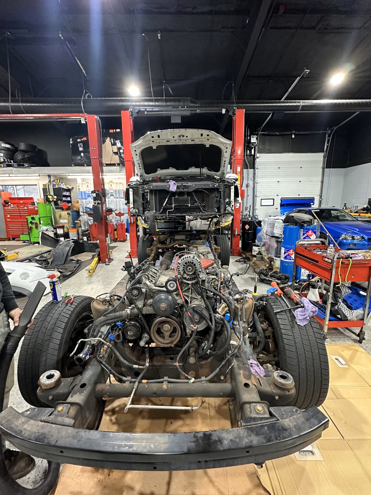

No lift. Take the grill apart, it's just a bunch of busy work. I chose not to remove the ac condenser. I wish I would have. It couldn't really be moved out of the way, so I had to work around it. If I had that part to do over, I'd open the ac loop and remove it.
