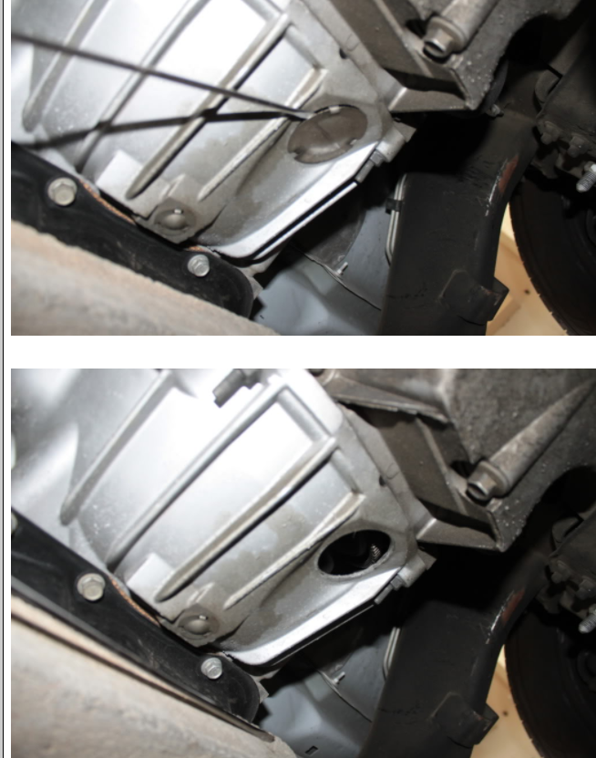

I was talking about checking both aforementioned possibilities. To check for a cracked flexplate without removing the trans, you can pop out the inspection plug and look inside with a flashlight. It's a round metal plate that can be popped out with a small flathead screwdriver that'll give you a about a 2" hole to look through. Sure, you won't have as clear a view as with the trans removed, but at least it's a quick and easy check that'll allow you to (hopefully) eliminate it from the list. The second part was for visually checking for a clogged cat. But, I completely forgot that these things have two cats, one on each bank of the Y-pipe. About the best you can do with that for an at-home test is comparing the temperatures of the exhaust pipe entering and exiting the cat converters.

I have seen that inspection cover while changing my oil, Is this one on the image?

^^^ That's it.
You can see the teeth on the flexplate in the second pic. You'll have to look through the hole and between the flexplate and the torque converter that's bolted to it. But, spend a few minutes looking at it with the flashlight at various angles. If you see anything suspect and/or need to rotate the flexplate for a better view, you can turn the motor with a large ratchet and socket on the crank.
