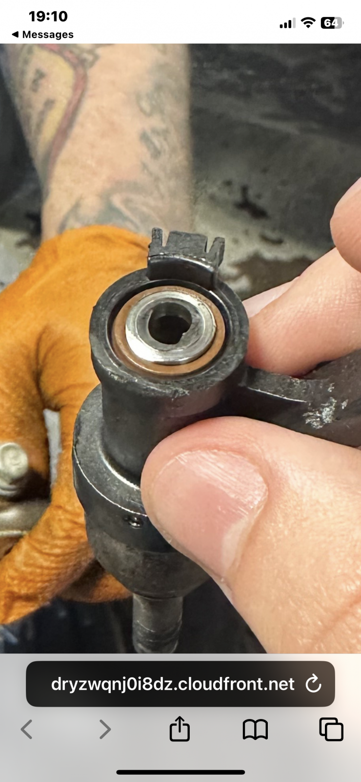

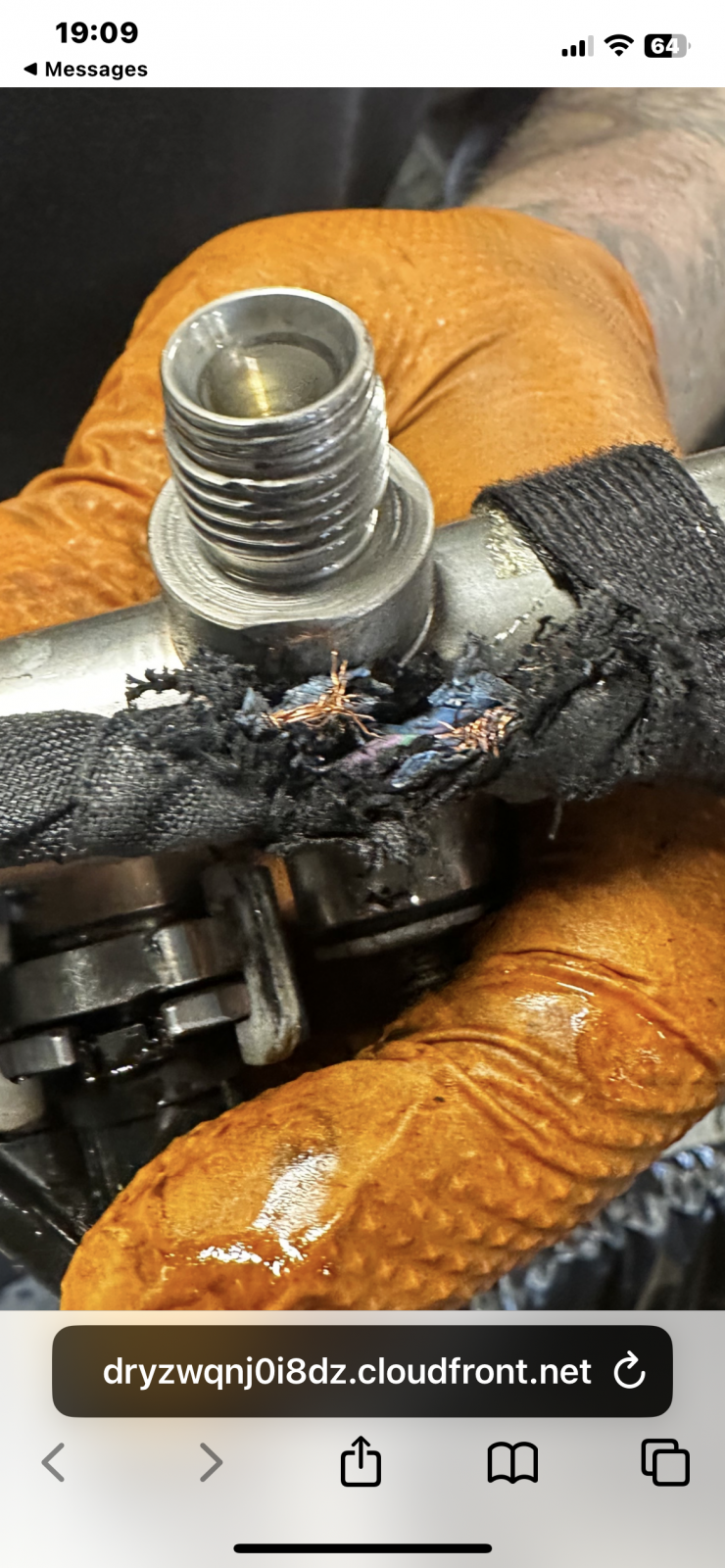

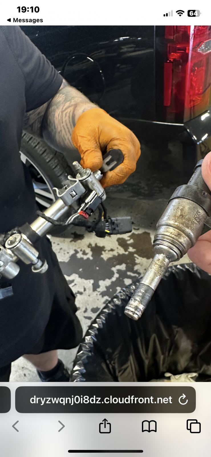

Photos of the injectors

Wow that is some crazy fraying on that harness. I betting the tech did that trying to pry the rail out, but sometimes it can't be helped if the injectors are wedged in tight.
I'm not surprised some may have broke coming out. Injectors on these engines can be a bear.
