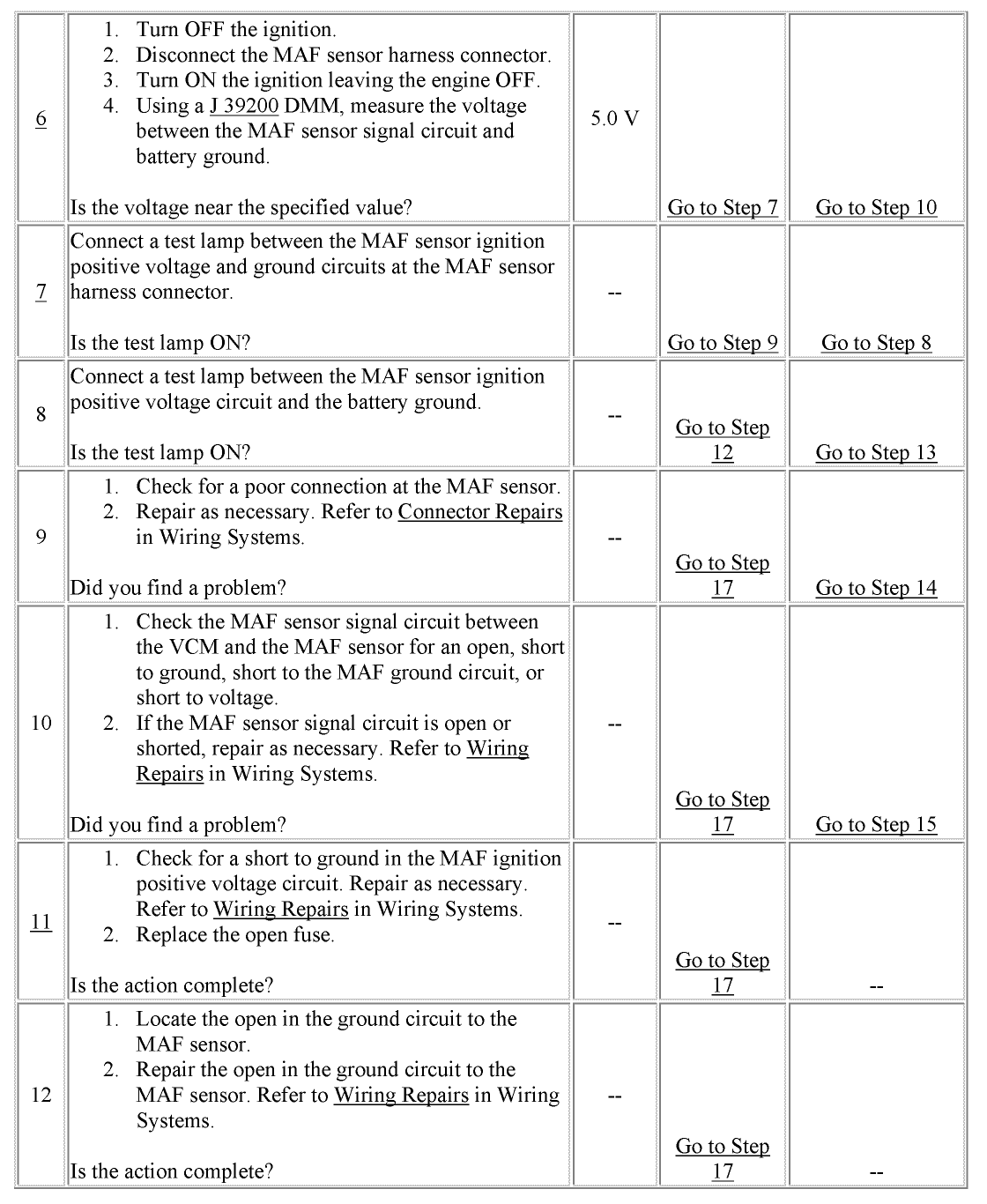

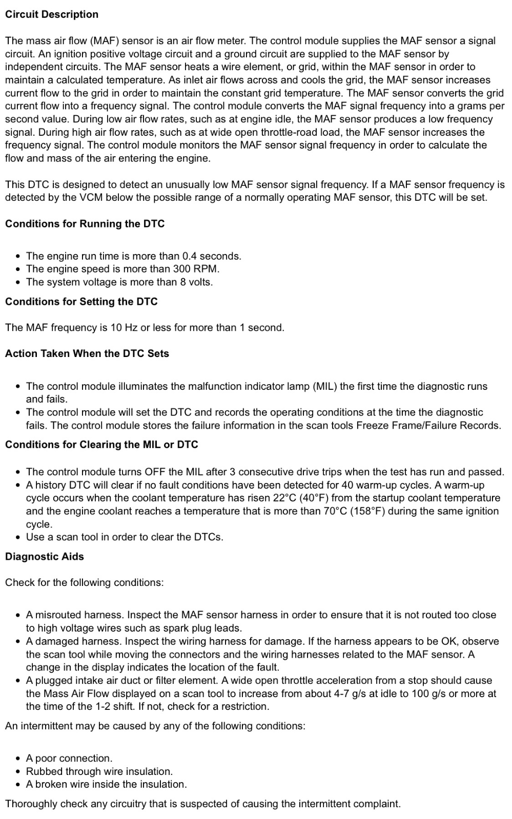

Here are the diagnostics for the P0102. The MAF is on the same circuit as the Evap, the issues may be related.
Checked new maf with computer and the pcm wasn’t getting any information from it. Maf was at 0 g/s all the time. Replaced the fuse and now the pcm has information from the maf now. 100% better, no more hesitation when accelerating or under a load. While I had the computer, I was looking at the misfires it was having while idling and the computer barely picked up on it but the misfire had a distinct feeling. I’ll be replacing the injectors, already tried a whole bottle of chevron complete fuel system cleaner 32oz at a quarter of a tank. Still have the feeling after the cleaner. I’ll update after the spyder injector replacement.
