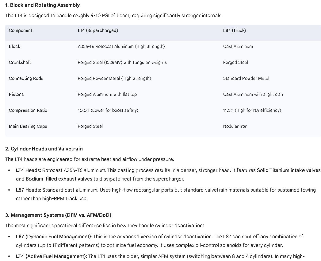

The V engine is not an L87, it is an LT4. Different parts for a lot of things, specifically crank, rods and pistons.

LT4 has different part numbers for crank, rods and pistons than the L87. I was looking in the parts catalog a little while ago.

Rods and pistons are different
Oil pump/pan are the same
Heads/gaskets are different
Throttle body's different
Injectors different
In tank fuel pumps different
High pressure pumps different
Fuel rails are the same

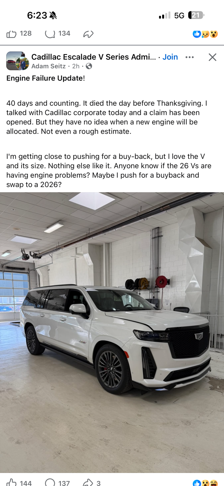

How many miles? Did it have you governed for the first 500 miles before it would scream like the blackwings do?
This is not my vehicle, and I do not own an Escalade V. This is just a screen shot from a Cadillac Escalade V Facebook group post.
