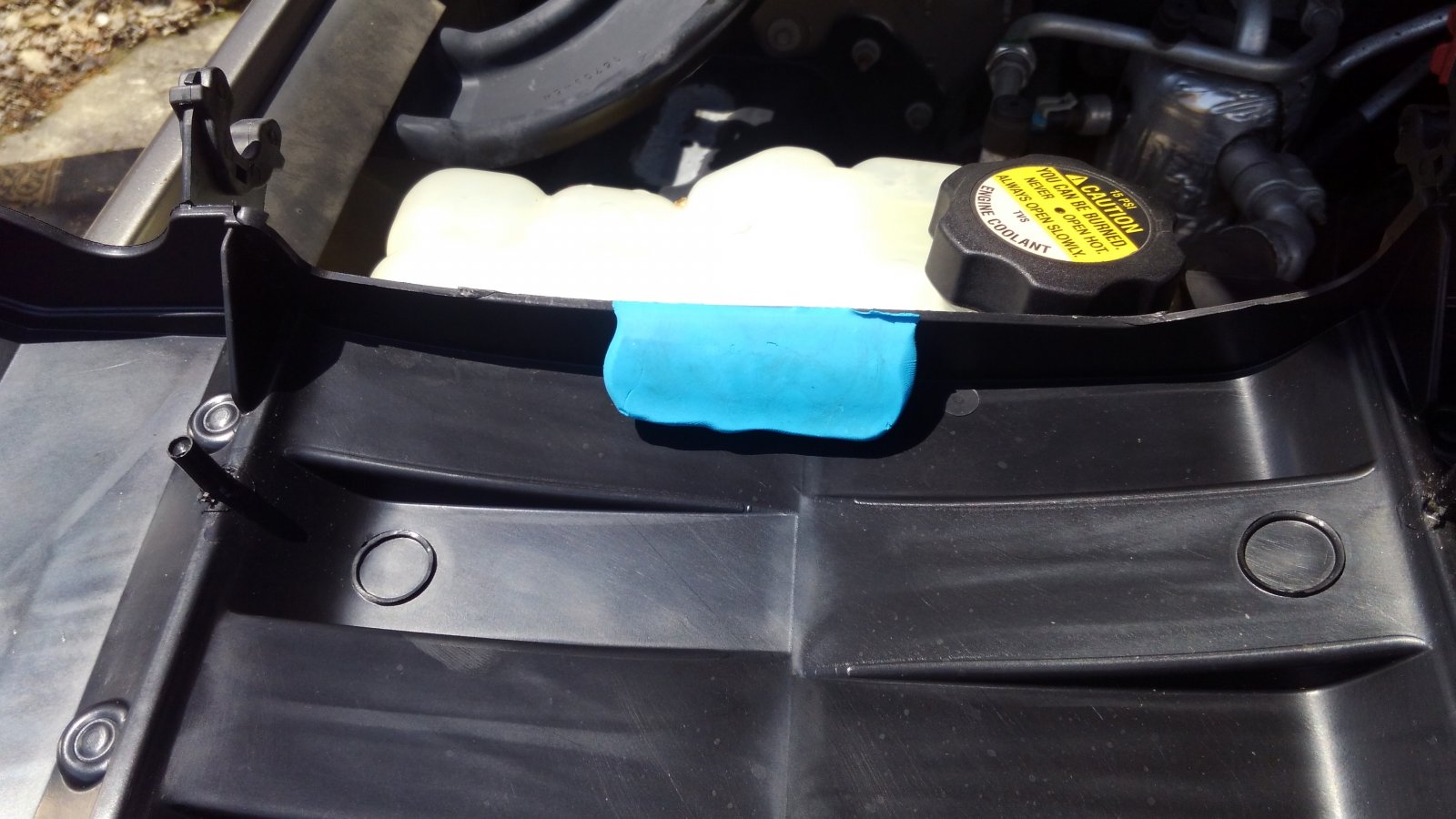

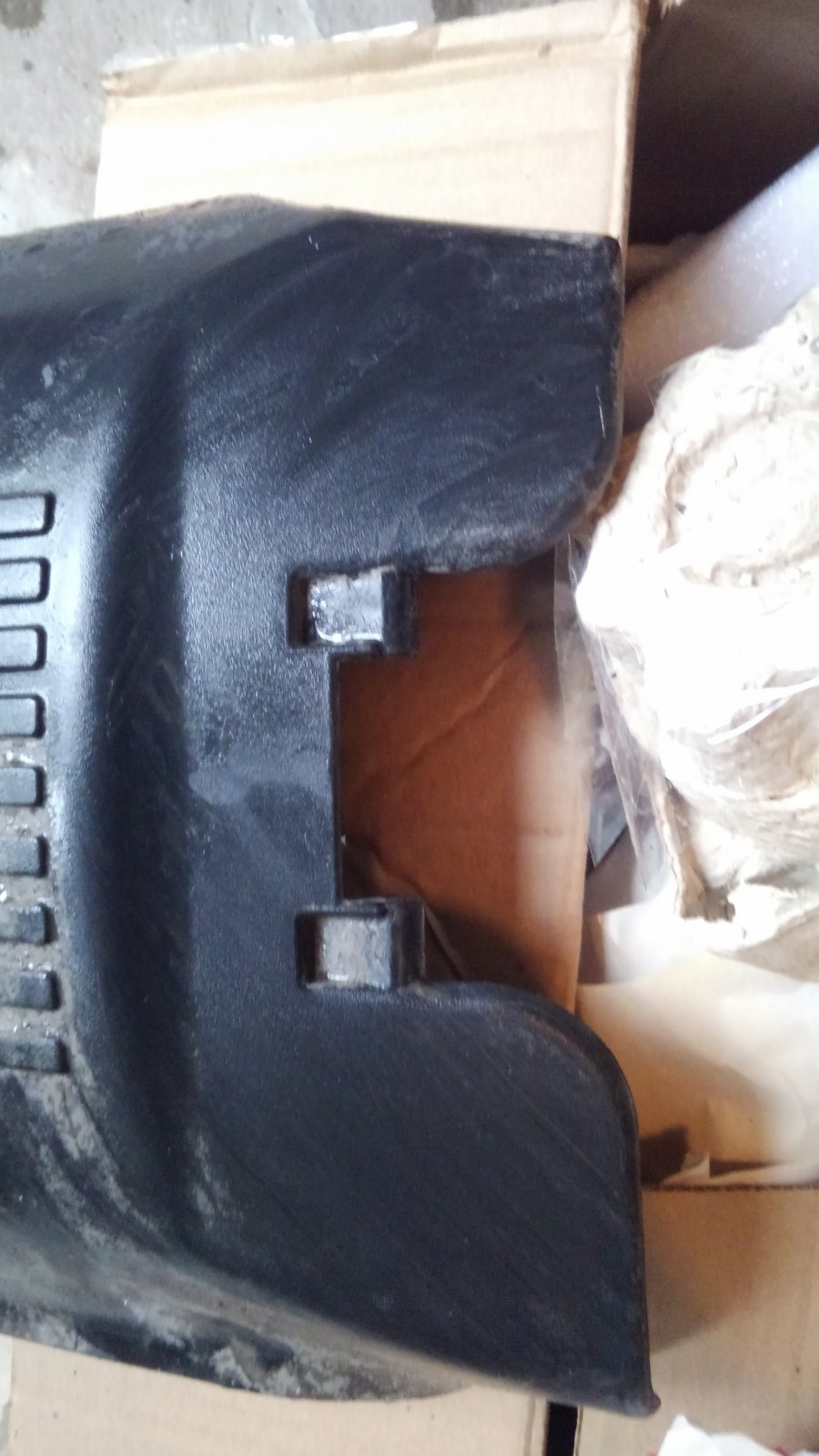

Started on the cover by removing the liner inside. I used a small screw driver to bend the retainer ears and popped everything out. I need to cut some areas to clear the heater hose and such so decided to make a hot knife out of a soldering iron.

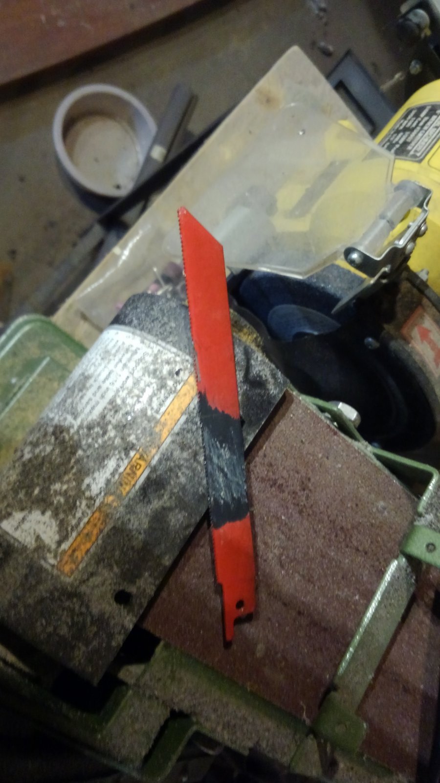

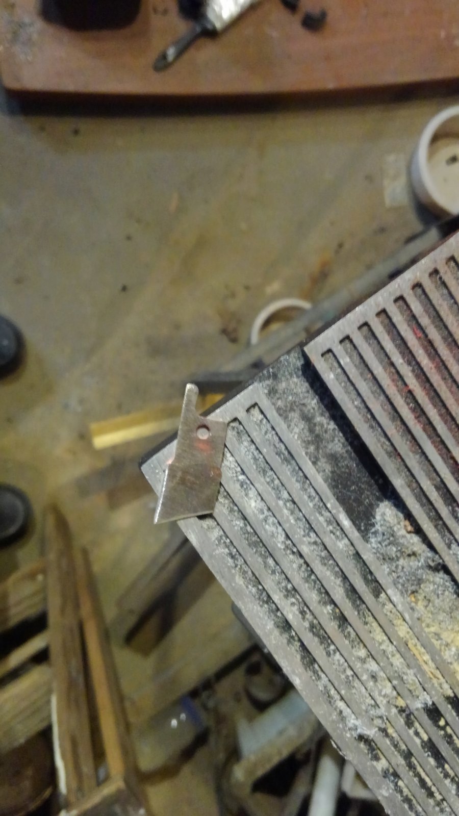

I started with a sawzall blade.
I used the bench grinder and belt sander to cut it down and remove the paint.

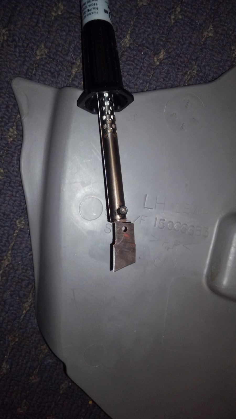

Here is the final result.
The hot knife will give me finer control on some cuts. Then I'll use a Dremel to clean up the cut areas.
