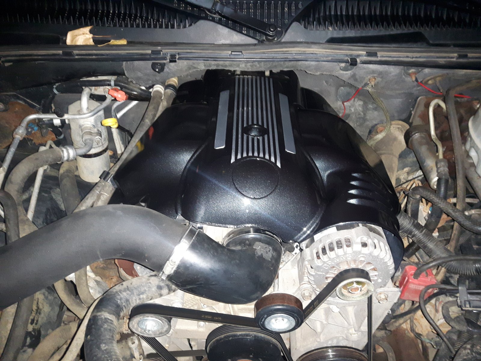

Looked at the Hoe real close to see how it's getting air. I'll be adding a wing to the area near the front wheel to scoop in more air. It's actually in a near dead air space as it is and if I put the front dam on? It will be worse!
I'd bet that this is yet another engineered sacrifice. Sure, what could essentially be a "ram air" intake could produce a minimal power increase at speed. It was probably decided against for aerodynamic purposes and to reduce the chance of water intrusion from rain or leading cars splashing up puddles. Having it ducted in from a dead, but safe place was the compromise.

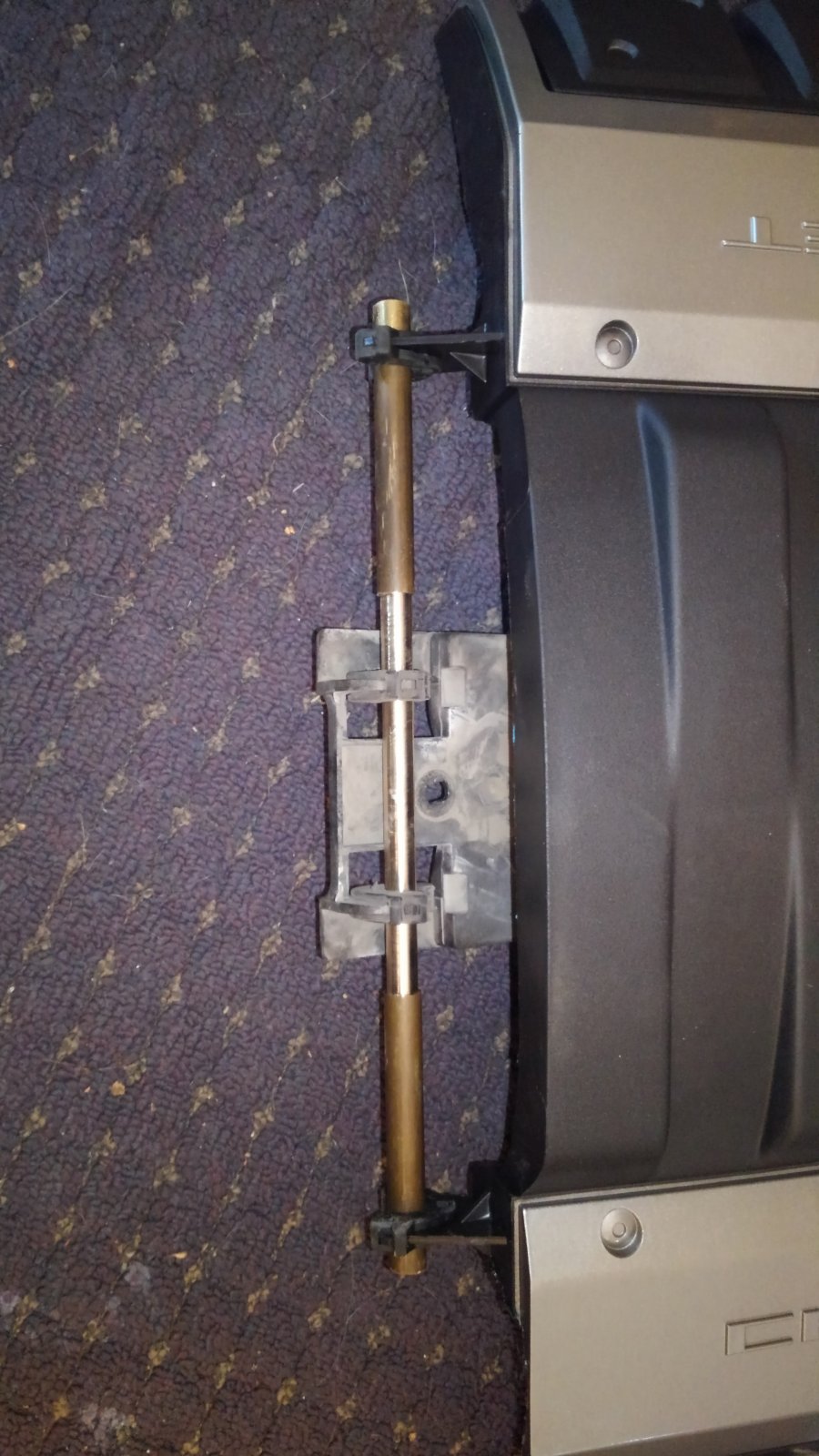

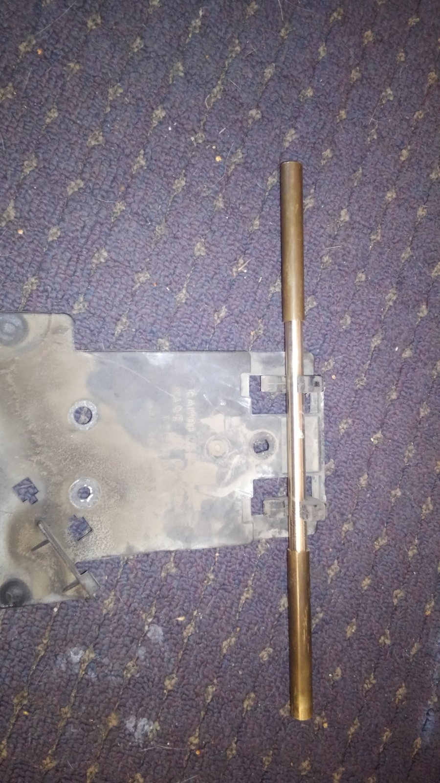

Now. I stumbled on a part in my basement work shop that makes the rear attachment problem easier!
I found a brass rod that fits the attachment areas on the new cover and the mount on the engine! So I cut a piece off and tested it. All I need to do is drill new holes in the engine mount to move it forwards just a bit!

The brass rod fits the Camaro cover perfectly but is a little large for the stock mount on the engine.
So it's into the basement to turn it down on the lathe.

So here's the rod turned down to fit the stock mounts.
The rod was scrap I brought home and now I know why I kept it. I could have made the part out of Delrin rod.
I was actually looking for some stainless steel rods I have around somewhere.

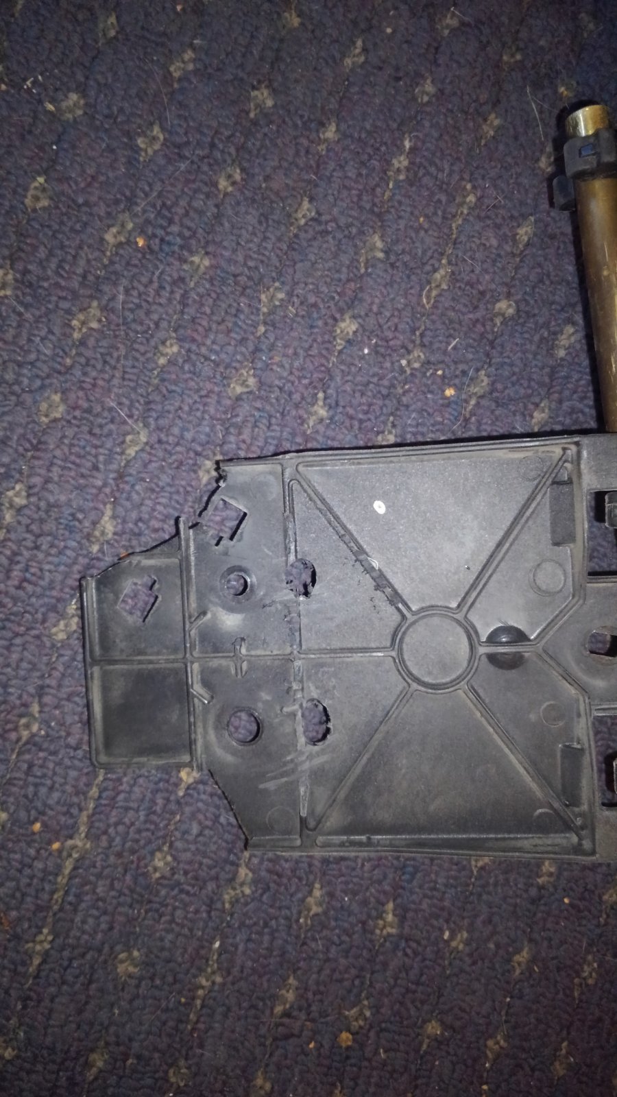

Now the stock mount is made to be idiot proof. I had to remove ribs on the bottom to slide it forwards.
I used the proven scientific method of grabbing them with channel locks and snapping them off.
They were made in Canada so what the hell.
Also cut the corners to clear the wiring better.

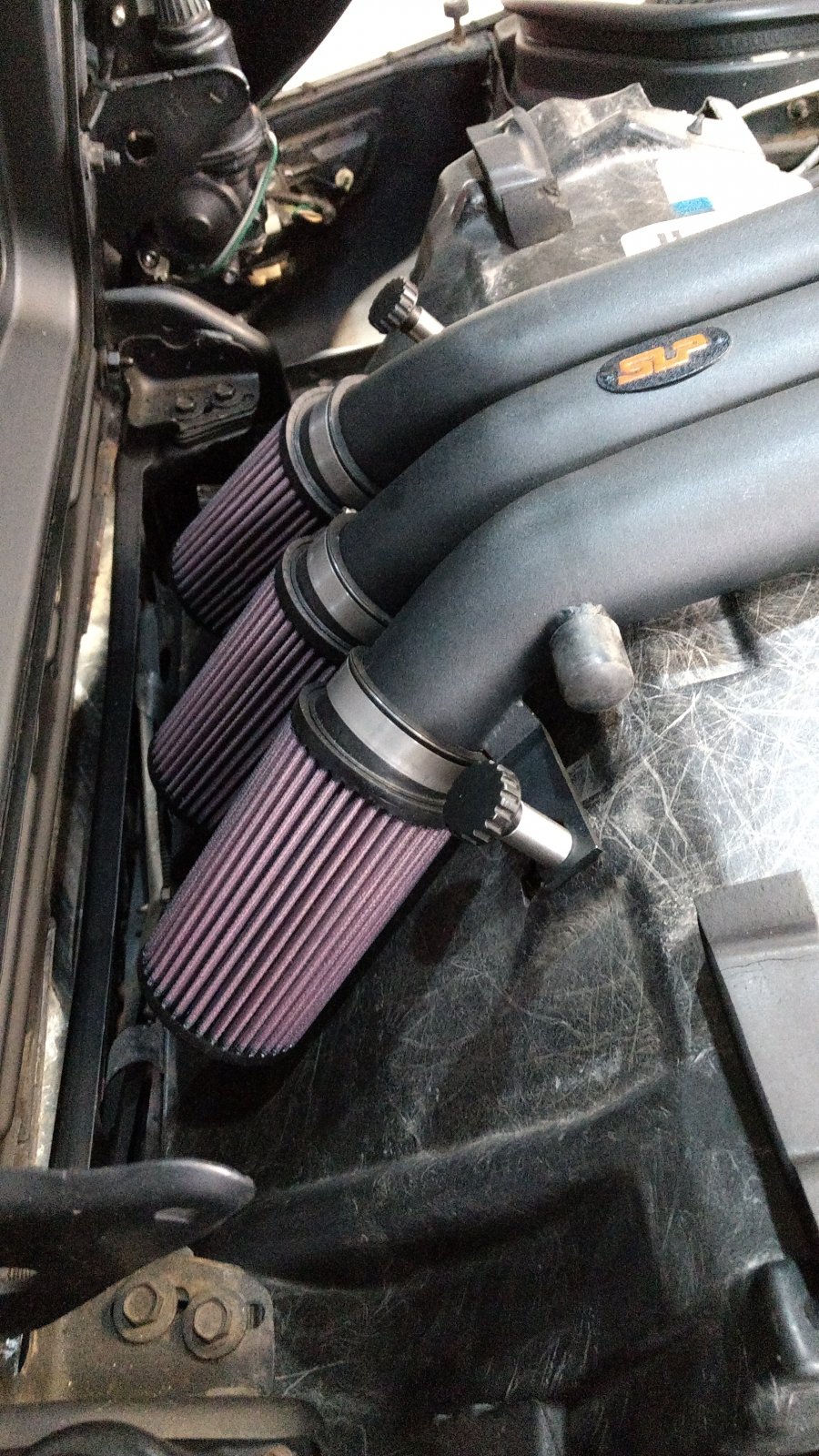

did something similar to my C4 SLP CAI.. a little orange paint on the logo.
