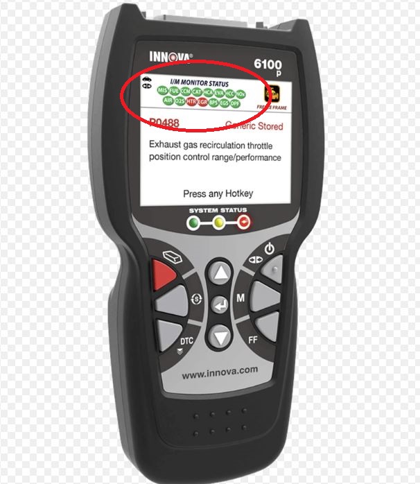

depends on your scanner, many have a display like this one with little indicators green is ready, red is not ready, the tech2 has a im readyness menu, it is different than the small handhelds
^^ This ^^ Look for something like "I/M Readiness Monitors" or "I/M Monitor Status."
EDIT: I/M = inspection/maintenance
I don't have anything that looks like that.
When I scan for "other codes" (vs current) some of the readings say "not tested" since last start. Maybe that is a clue.
I'll research if it has readiness status reports though. Darned thing (Autel MD906 Pro) didn't come with a manual but there probably is one out there.
