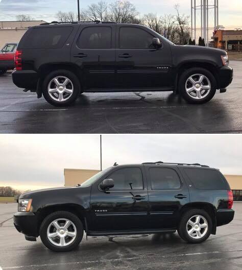

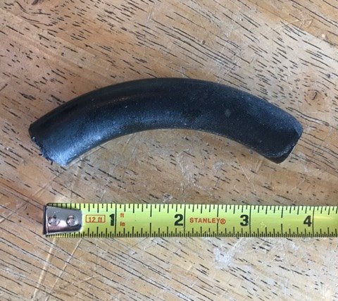

I removed a short piece of coil in the front right. Now it sets perfectly level front to rear, on both sides -- however the right side is still higher by 1/4 inch. It's unnoticeable by the naked eye, and who knows, maybe another 100 miles in, things will settle. Im happy with it as it sits now. It looks level, and that was my end goal.
View attachment 188680 View attachment 188681
Did you measure this with a full tank of gas? It may sit level left-to-right with a half or near-empty tank. I mean, it's nitpicking, but I wanted to mention it in case it offers any more closure.
Yes, and believe it or not - the more fuel in the tank the more even it sat. I purposely ran it down to 46 miles to empty today and my right side is closing in on that 1/2 inch higher mark, 1/4 inch higher when tank is full. The only thing that remains constant is the Front to Rear is level, regardless of full amount.
