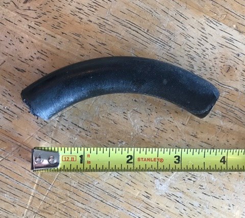

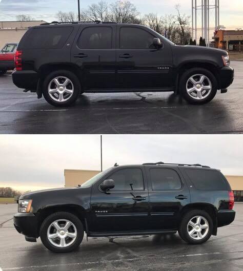

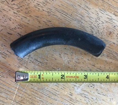

I removed a short piece of coil in the front right. Now it sets perfectly level front to rear, on both sides -- however the right side is still higher by 1/4 inch. It's unnoticeable by the naked eye, and who knows, maybe another 100 miles in, things will settle. Im happy with it as it sits now. It looks level, and that was my end goal.
