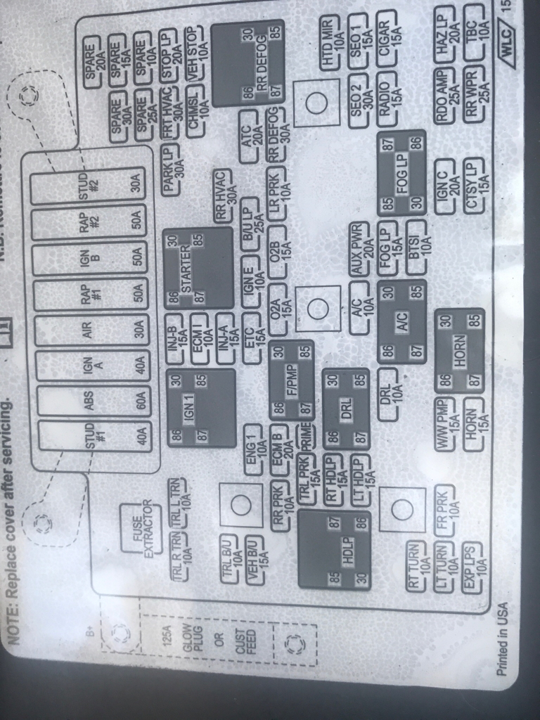

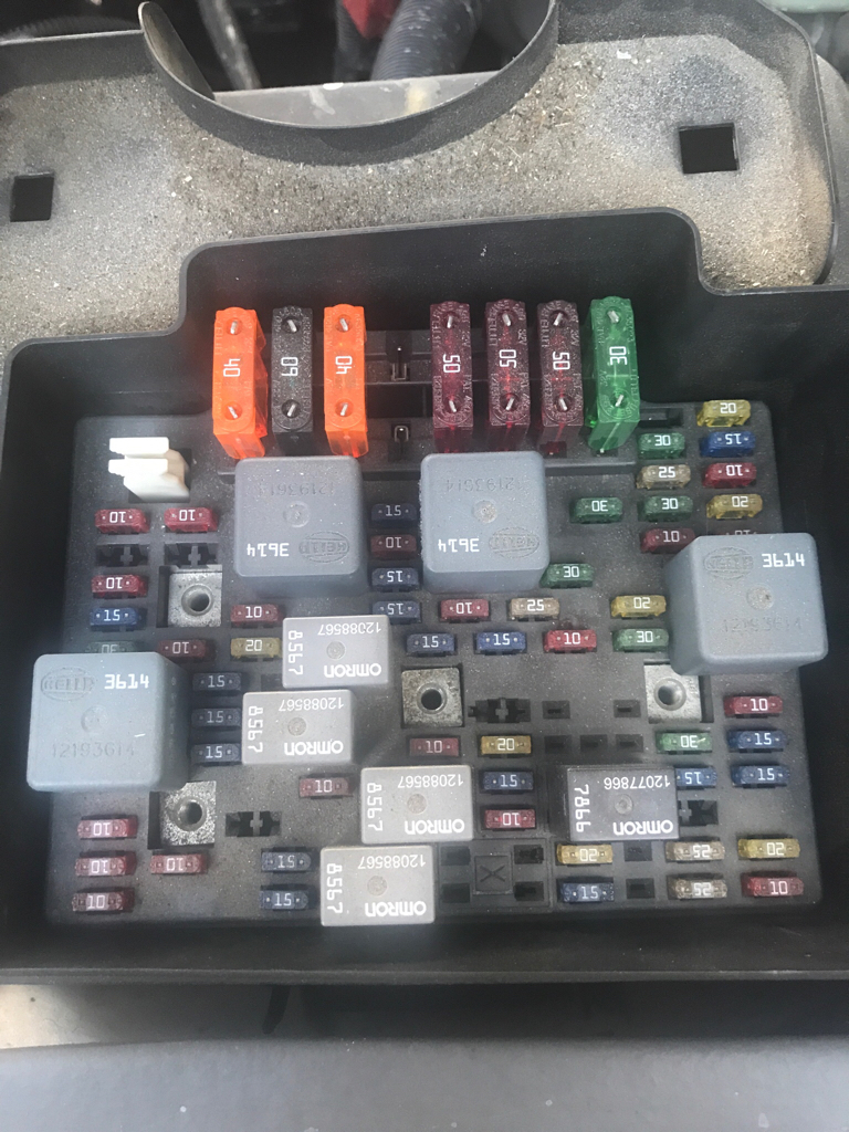

Well, I found it. It is not on my fuse id label. Googled it, and found it. Thanks for this info, worked perfectly.
52,954
Was it the 30 amp fuse above the headlight relay that isn’t labeled on your cover?
