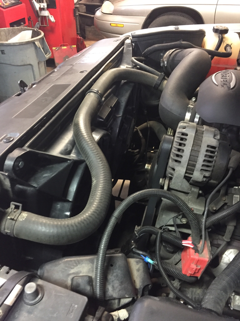

For all those who have done this swap, I recently completed mine and have noticed something odd about when the high fan 2 kicks in. Recently, in the mornings (50-60*), I put the defroster on and eventually switch to heat and notice that the high fan 2 will cycle on for about 5 seconds and then off and it repeats this process about every ten seconds. This is before the engine reaches operating temp and continues to do so once to temp. I verified the I tied into the correct a/c switch wire, per the LS1fans install instructions, so im baffled as to why this would be happening. Otherwise, this has been a great improvement.
Once you installed the fans did you have to get it tuned to turn the fans on? I bought a set of fans, now I have to get the harness from LS1 FANS also. Could you post up some pics of the install. Was it a direct fit once you pulled the clutch fan out? How hard was it to get the old fan out? Tia.
When I did mine it was a direct bolt up. I purchased my harness from Nelson Performance, and it was super easy to install and was $89 for the kit.
