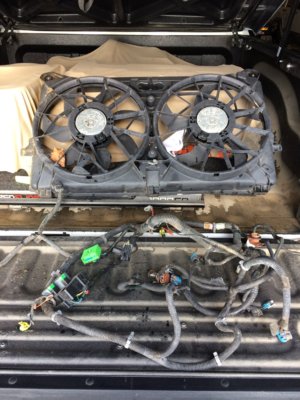

Ended up with the fans and complete front end harness and fuse block for the fans. They pulled for me, grand total of $117.
Wow, that's a REALLY good price! And then add in the fact that they even pulled them too? Plus all the wiring, that's really a steal. The fans alone usually sell for around $100 at most yards.

Started with this mess:
And ended up with this:
Yes that’s the dining room table, my wife went to town for the evening [emoji3]
I seem to be missing the pin to run to the PCM, but there is a small 2 pin weatherpack connector just down the line from the fuse block with a green and blue wire, I suppose either find another JY truck and rob the connector or run my own wires? Pretty sure I can source a PCM pin online.
Blackbear was nice enough to activate the fans with my original tune, so that’s sorted.

If you are missing the section of the harness that goes to the engine computer, you can actually just get a single pin and splice it into your harness. You really only need one because the green wire is the only one that will go to the computer. The blue wire will need to connect with the AC compressor trigger wire, but be sure to use a relay to change the polarity from positive to negative.
You can find a green wire with a PCM pin on just about any LS engine truck. Just unplug the computer and peel the wire loom back and look for a green wire. Then use a small pocket screwdriver or a pic to remove it from the PCM plug.
