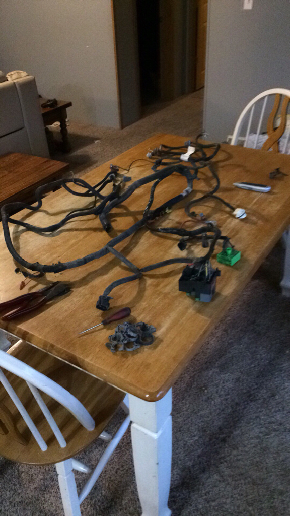

I'm fresh out of OEM harnesses for the time being. I pretty much ransacked every self service junkyard within two hours of me, and I got EVERY OEM fan harness that I could find. The ONLY harnesses still available around here are at the full service yards and they won't even sell them unless you want to fork out $150-$200 to buy the ENTIRE front wiring harness off the truck.
I've considered making some custom fan harnesses to offer for sale, but I'm just leery about the long term reliability of the relays. Especially since Nelson and LS1FANS have both had melting problems with theirs. I've seen some 80amp relays on Amazon and wondered how those would hold up to the current and the heat.

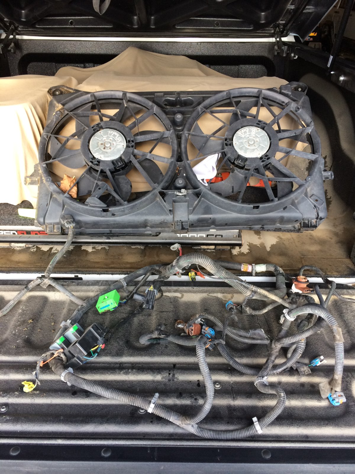

As luck would have it I may have located a '05 Silverado 4.3L at a local yard. Rockauto shows the same P/N across the board for cooling fans so I am going to try and check it out tomorrow; hopefully I can scoop the fans and wiring harness both.

I can confirm, that the 05 v6 trucks had the same fans as the V8 trucks. I've pulled a few myself. I'm not exactly sure about the radiator, but it's definitely wide enough to use the same fans so it's a 34" radiator. Probably overkill for a V6, but that's what all the 05-06 (and 07 Classic) trucks got.
