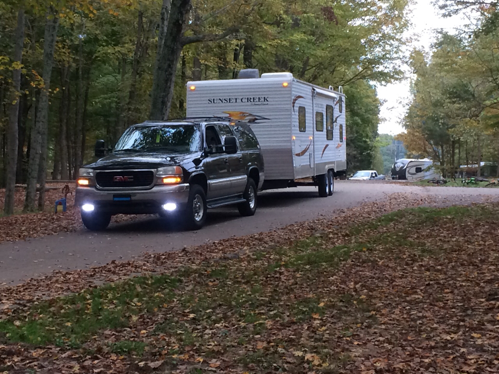

It works fine. 4.10s would be better of course but it’s not awful. We haul around 4 kids and all their stuff in this camper without too much effort. Just remember the 6.0 makes it’s power higher in the rpm range and don’t be afraid to run it at 3k all day.
Our previous camper weighed in around 8500lbs loaded and the Yukon struggled a bit with that but still managed.
I’m still on the lookout for a full float 14 bolt with a govlock and 4.10s but for now I’m happy. Right now we average 15 mpg mixed city/hwy empty and 8-10 towing depending on whether the camper or Jeep trailer is hooked up.
For reference, the 09 Sunnybrook (heavy SOB):
