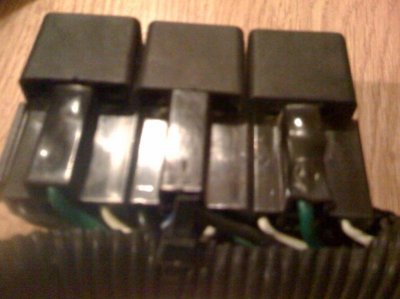

I have the new PCM in and they still cycled low. I removed a relay and it sounded like something was loose inside. I tapped on it and the fans cut off, but did not cycle back on based on engine temp. the one fan did come on when I turned on the a/c though. I replaced the relay with a new one and even swapped them around and they still will not cycle on and off. They stay on low until I turn on the a/c then cycle to high. pcm doesn't seem to know what the engine temp is so it defaults to keeping them on. no CEL or anything. weird...

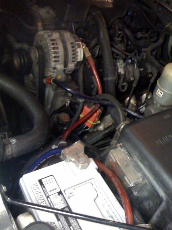

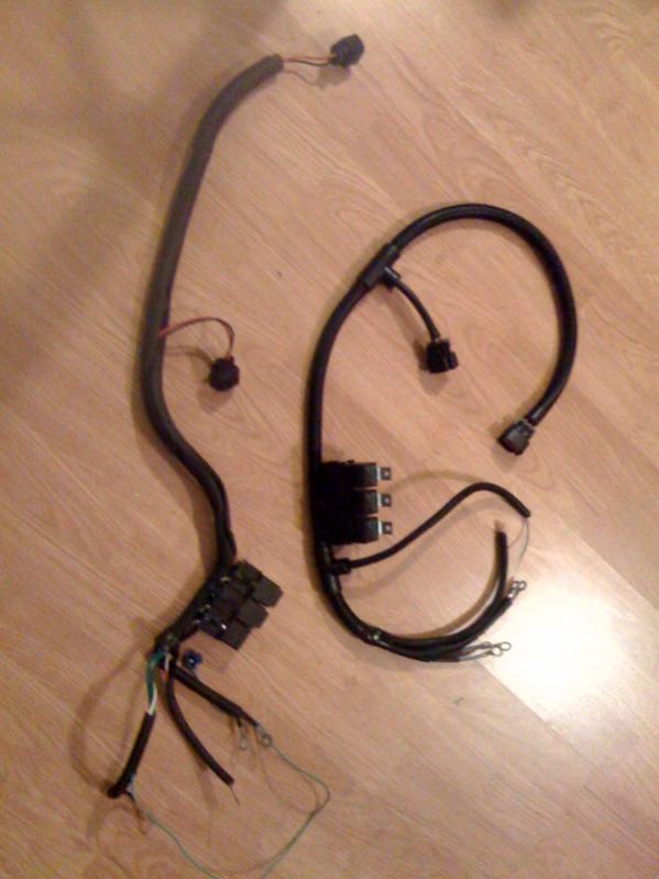

I'm bumping this back up since I still have the same problem. My blackbear harness was starting to melt at the relay so I decided to go ahead and get another one. I still have the constant on of both fans. I went with a Nelson harness this time and be damned if nothing has changed. I run my power wire directly to the battery from the alternator bypassing the junction box, but the fans get their power from the junction box by way of the pos wire from the battery to the junction box I seem to be the only one having this problem. Could this be causing my problem? I'm sure other people are bypassing the box.
I've done this install so many times its ridiculous. I would like to move on to getting my suspension work done, but this is irritating the hell out of me. any ideas would be greatly appreciated.

Are you sure you are using the correct A/C wire, the green one? There were 3 wires in the truck harness that looked like they would be the right color but all 3 had different characteristics to what they did to the fans! One didn't let the fans come on at all, one had the fans come on all the time no matter what, and the last one I found and tried that actually looked to be the correct one color wise made them work correctly!!

Yeah I actually went thru the same thing when I first installed the harness. I'm sure I have the right wire tapped and I even traced the wire back to the compressor. I can disconnect the a/c tap and the fans do the same thing, both cycle low. I turn the a
a/c on and they cycle high. I'm going to a wire from the alt to the junction box and see if this fixes the problem. Justin from blackbear even sent me a new PCM to remove some potential problems and I still have this issue. I only have one spot open around pin 42 so I couldn't tap the wrong pin if I wanted. I don't have any check engine codes or anything so the only thing left is the power supply.
