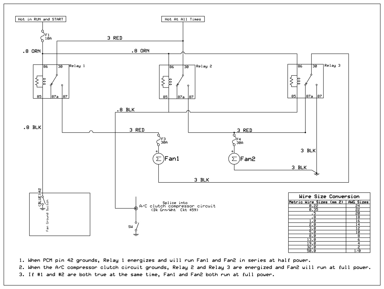

Ordered a wiring harness for my e-fan upgrade. Got screwed because vendor apparently didn't understand OVERNIGHT SHIPPING. Truck has appointment tomorrow to have water pump replaced and I will be doing the e-fan conversion at the same time since it's all pulled apart.
Looks like I'm either going to try to get a harness from the stealership or I'm going to have to make one on my own...unless someone has some other suggestions.
So....does anyone have a wiring diagram? Or a GM part# that I can use? The stealership won't look anything up without a VIN...and my truck's VIN doesn't support e-fans in that Y/M.
HELP!

Make your own
