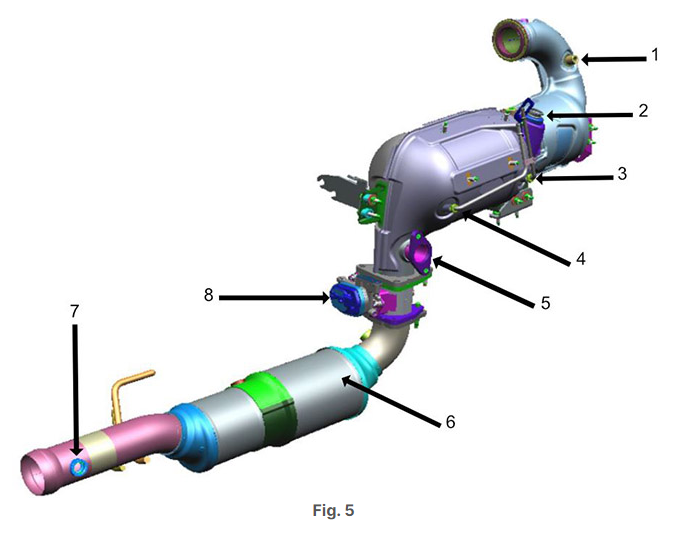

The 3.0l Duramax (LM2) has the DPF and SCR in the engine compartment which makes it harder to cut out. The Ram and Ford 3.0l diesels are under the truck like the 250/2500 and 350/3500 trucks. The LZ0 (only in the Silverado/Sierra) is slightly different than the LM2.
StephenPT
Jan 16, 2022
1,252
1,268
St. Helens, OR
Correct - the SCRF (GM's term for the combined SCR and DPF assembly) is located in the engine compartment. However there is still a catalytic converter on these rigs and it's down by the frame rail. Item 6 in the diagram below.
