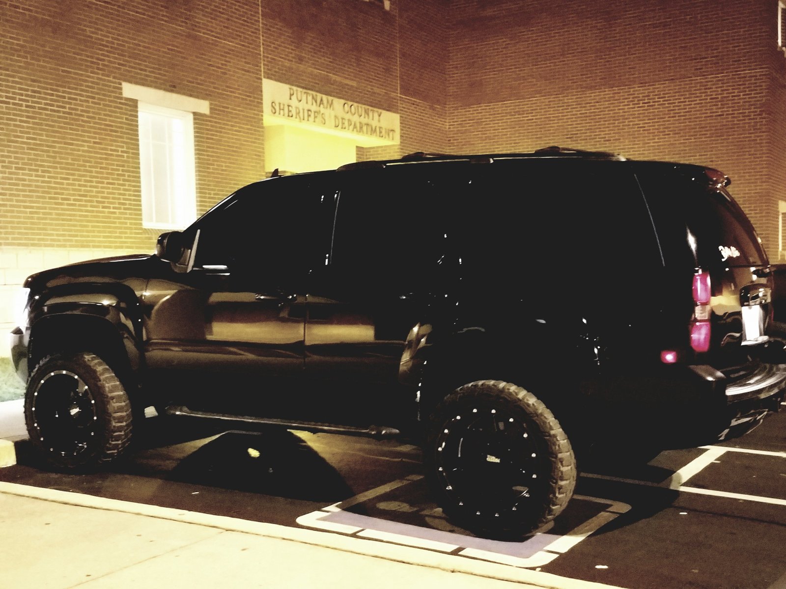

I really like my '07 Denali. The body style and interior from 2007-2014, the aftermarket options, etc. Long term, I'd like to look into 14 bolt conversion and 6L90 upgrade (6L80 now), overbuild the Denali to handle the winter camping, hauling, etc. abuse while retaining the ability to drive everyday, take the wife and kids out around town (3 kids - because, irresponsibility). Maybe a mild lift, 3-4", nothing with huge tires - I think that is what the picture below has. 20901437_10155752074442578_8992367235081523115_o.jpgThis wouldn't be a rock crawler, no SAS for me... But, it would hit the mountain every winter and haul loads in the summer - I'd get closer to my dreams of a boat too.
