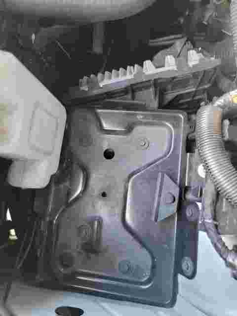

My tray is exactly that #... I had to install the battery hold down block before putting the tray back in as there didn't appear to be any threaded receiving point...
I have questions regarding the battery side of things.
What did you change on this box? If anything
Sounds like you figured a way to make the existing battery tray work, but if it didn't have a threaded hole, it was most likely the stock tray. They look very similar, not sure why GM just didn't use the same tray that would work for both.

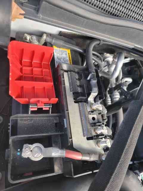

On the vehicle battery side of things, it's actually kind of neat, you'll see when you get the new cable assembly. It comes with a connection that just plugs in to the side of that plastic fuse assembly on top of the battery. That way, it's actually a quick disconnect fused connection for the Aux battery.

The correct part number for the battery tray is
22989633​
23231841c is what comes standard and does not have the correct provisioning for the battery.

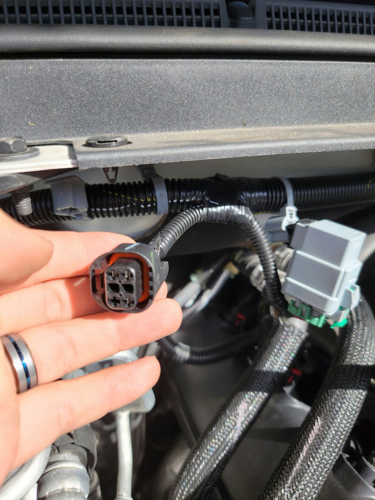

Anybody know what this harness partners with?
has a "PBT GF20" molded into it, but google seems to disagree.
This is in the positive battery live to activate the relay, that activates the isolator...
rumor has it, it partners with a harness that is blocked off by the primary battery, yet it appears to be absent on my truck.
so the next task is to find the signal pinout in the box and make my own connector.
This is where the Keyline VSR is the better choice :-/
On my 2020 Tahoe, there was no connection for this. I just replaced this relay with the Keyline VSR.
