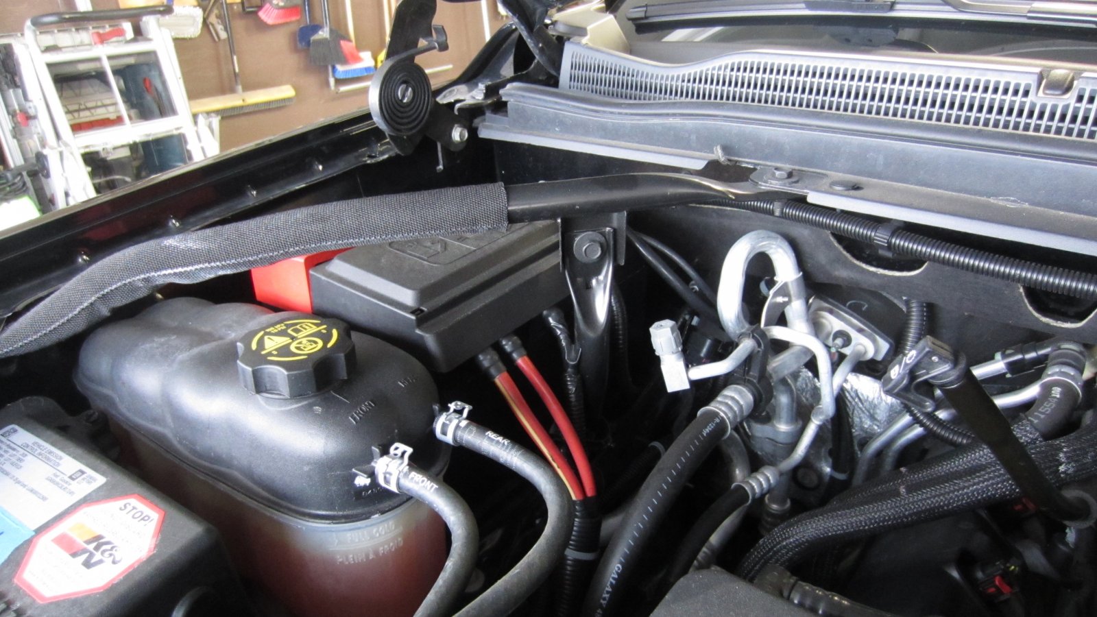

Hello, new guy here.
2020 Tahoe LT Z71 Midnight Edition, 5.3, 4wd
Truck isn't a PPV, but seems like this would be the best forum to ask about an OEM Dual Battery Setup.
I know there are many options, Straight Parallel, DCDC Charger, Aftermarket Isolator, but I want to keep everything clean using OEM parts.
I've already bought and installed the new battery tray and hold down, and a new Interstate AGM battery.
From the GM Parts Direct site, I'll also need Fuse Box 23239735, Negative Cable 84354710, Relay 12135194, and Positive Cable 84355668. Parts total about $250.00 with shipping.
I don't think this will be too hard to do, but I was hoping someone with a 2015-2020 PPV could post some pics showing how all the cables are run and relay connected.
Thanks!

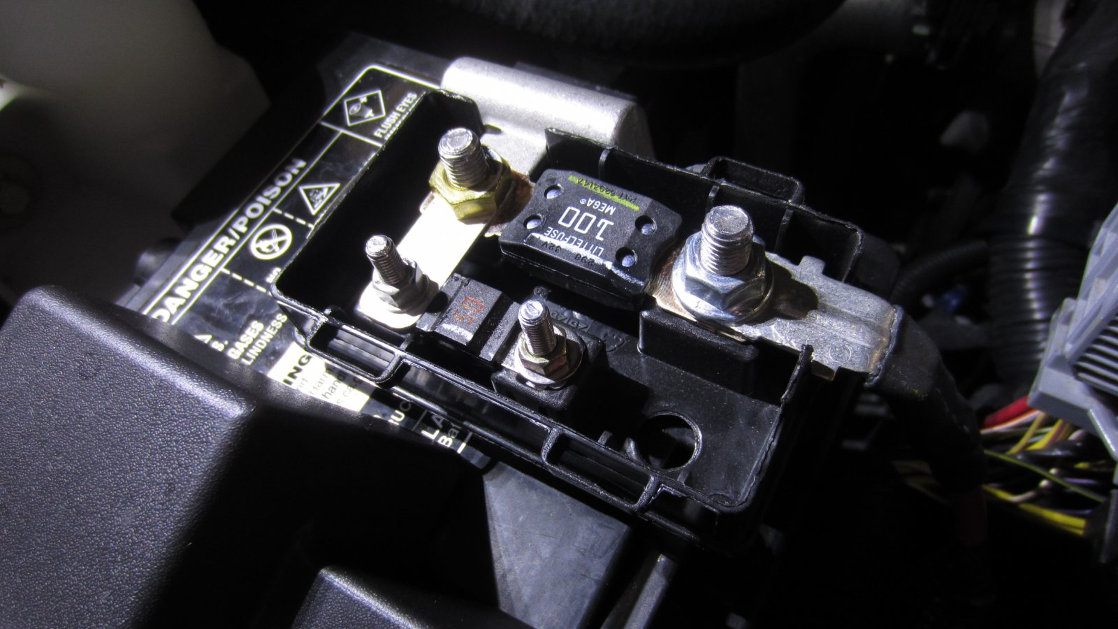

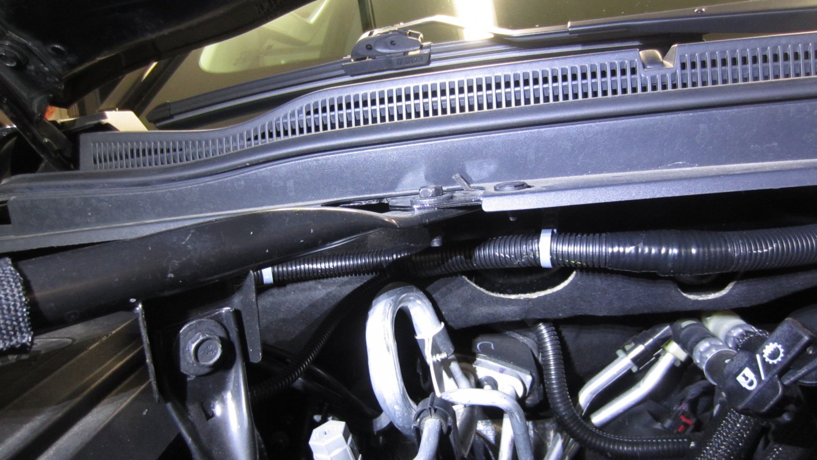

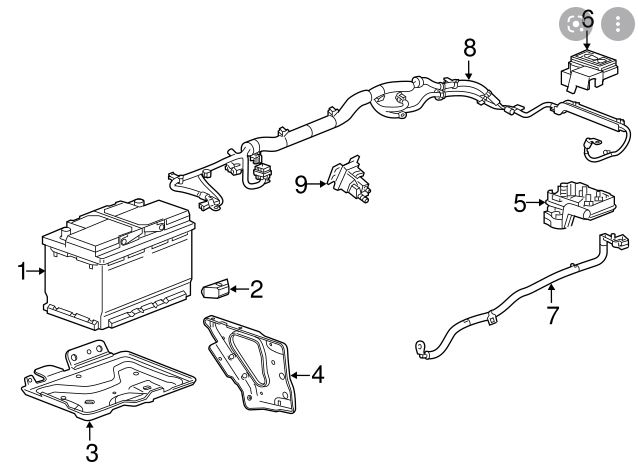

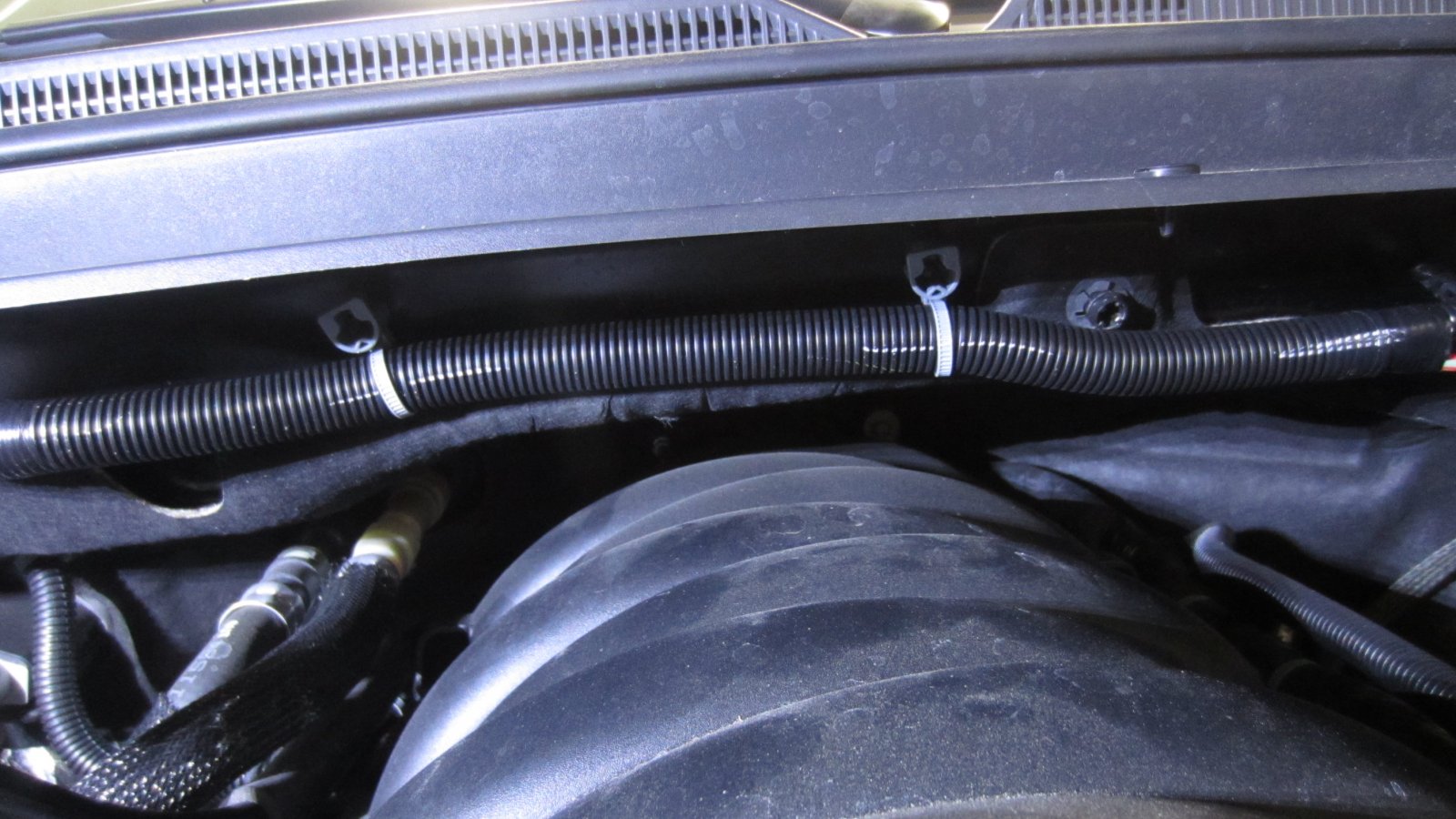

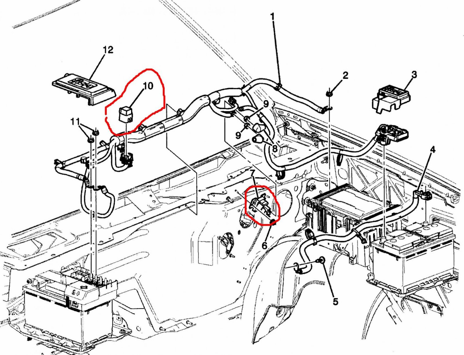

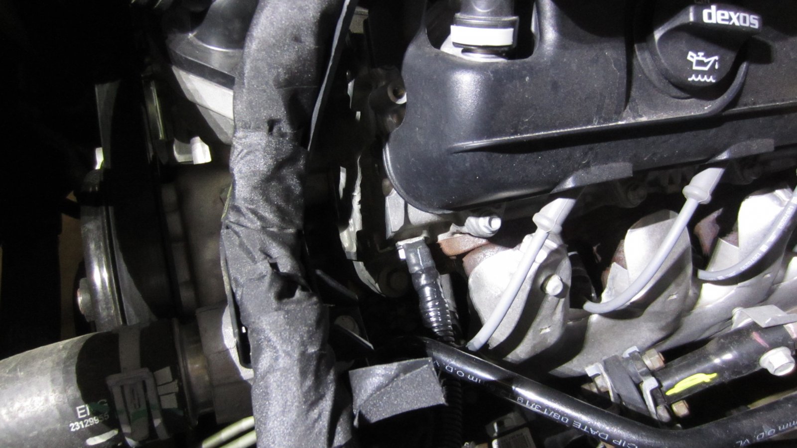

I haven't seen any write ups on it but it looks like this is the basic diagram, not sure how the isolation relay #9 ties in but the "fuse box" #5 is the 2nd battery positive connector with 100 and 50 amp fuse's, the negative cable #7 goes from 2nd battery terminal to block next to the temperature sensor, the positive cable #8 goes around the engine bay outside edges. #6 is the fuse box cover

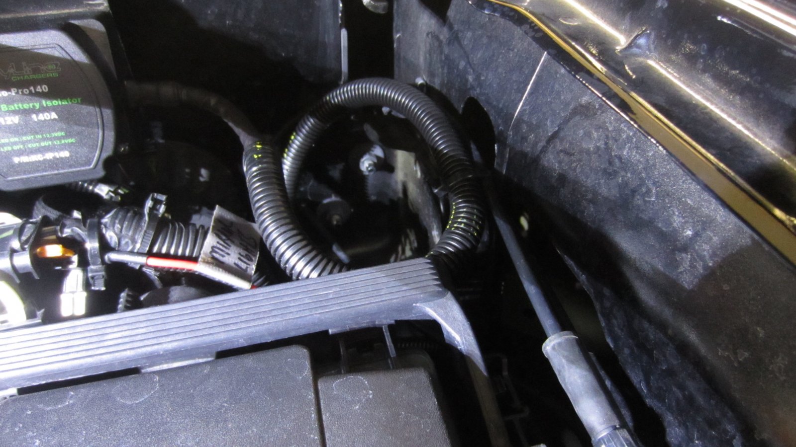

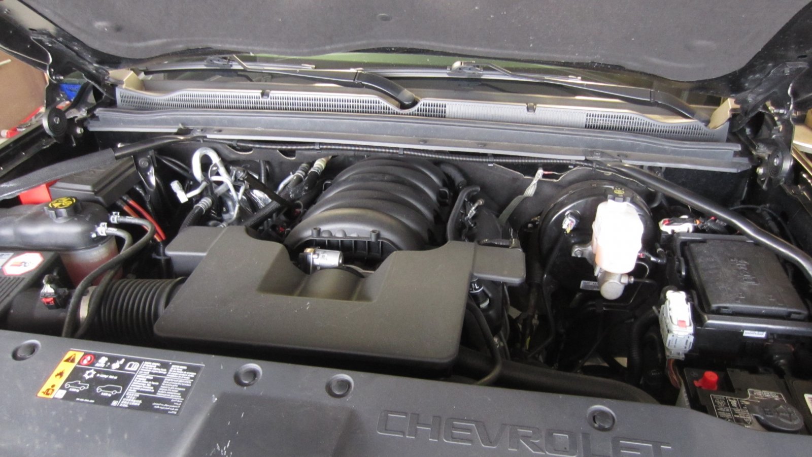

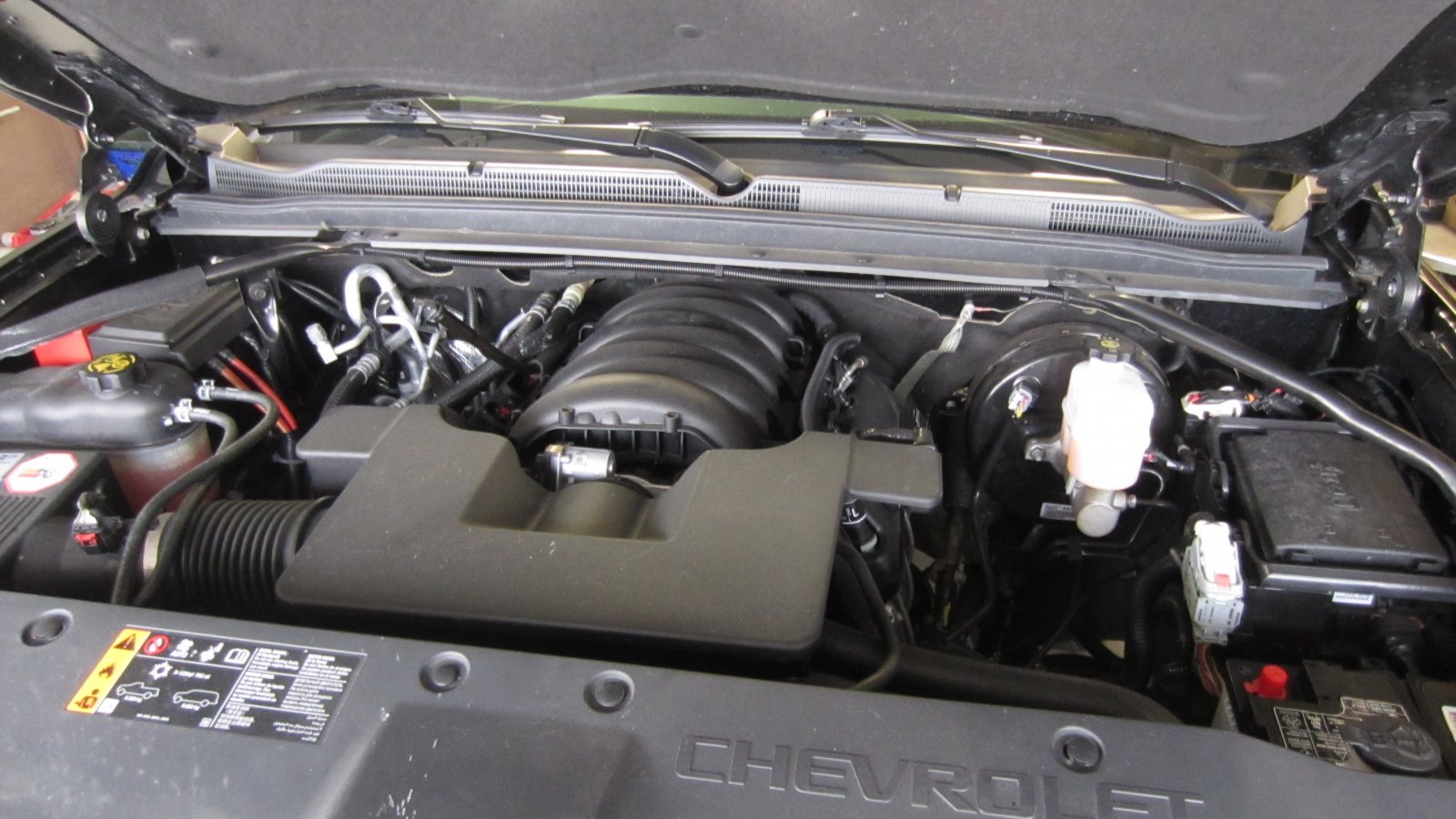

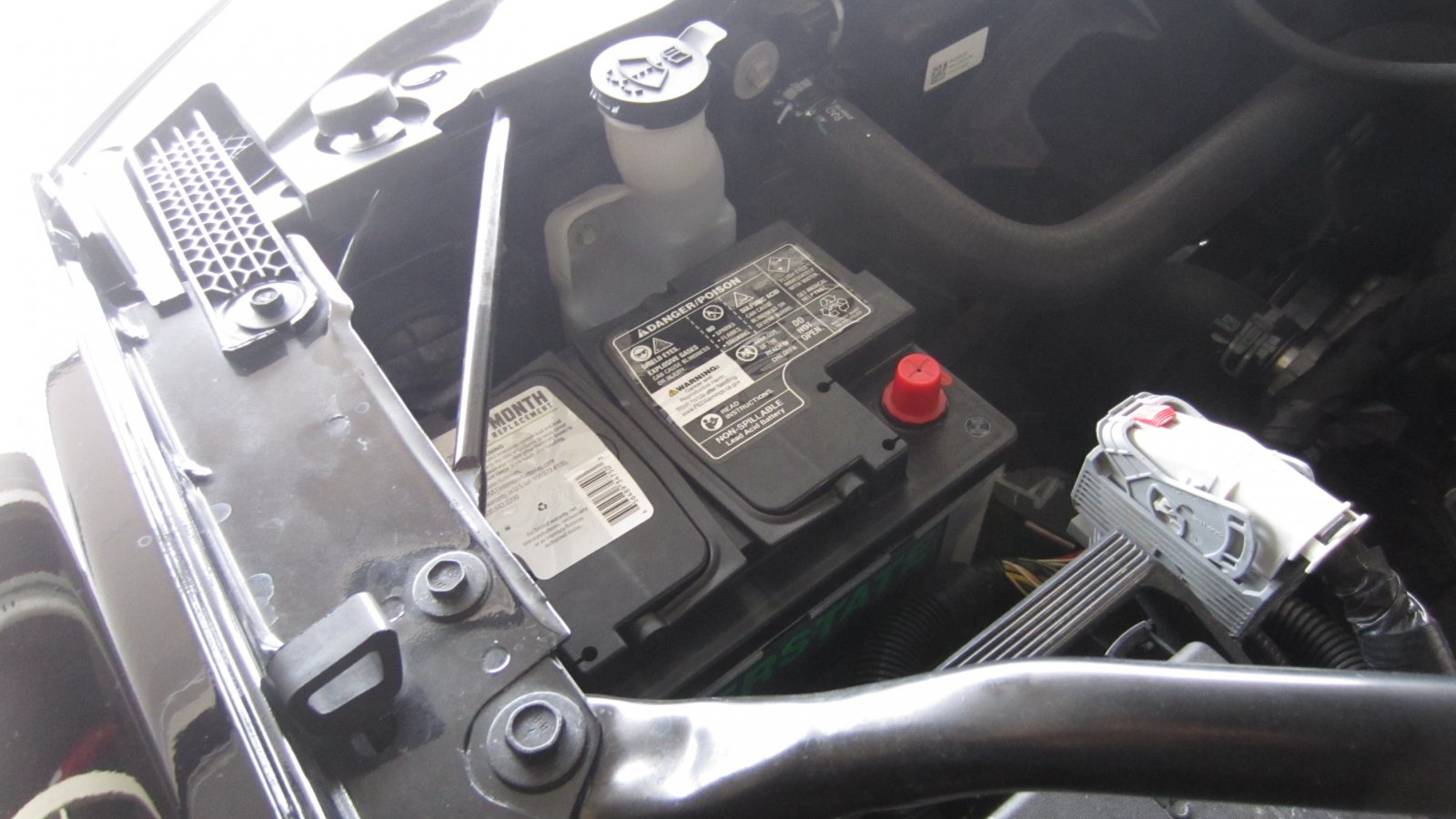

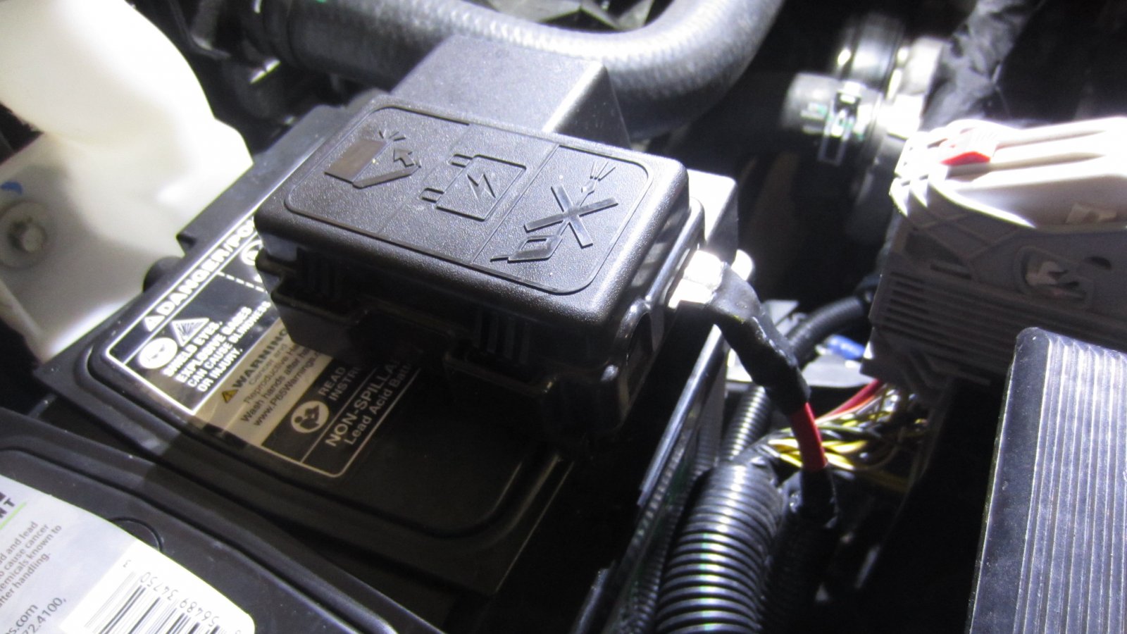

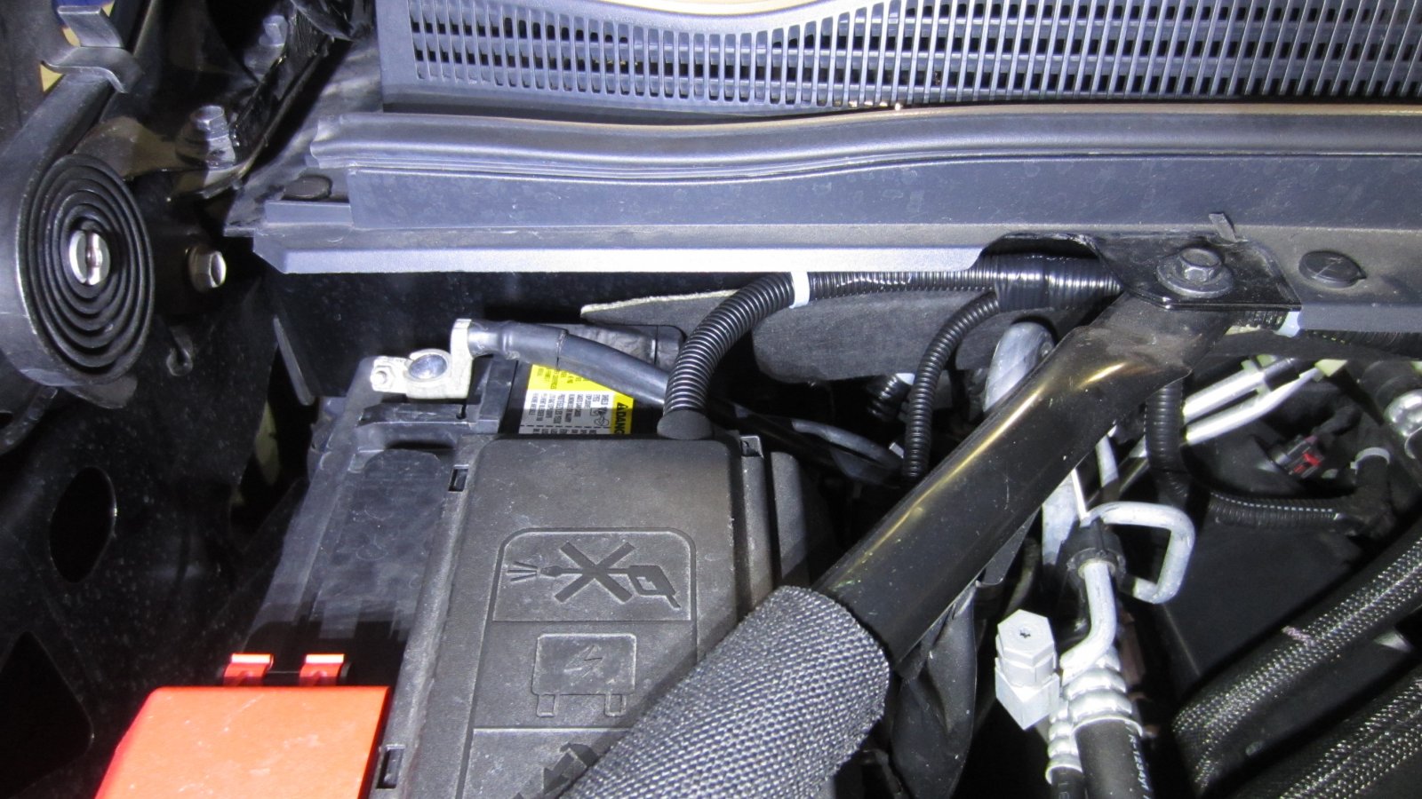

For anyone interested in doing this, I've learned a couple things. First, before I forget, in addition to the parts I've listed above, you'll also need the positive battery post cover. Part # is 22945779. It has been discontinued, but you can still find them on Ebay. You'll also need the battery tray, and battery hold down, and bolt, parts # 2 and 3 in the pic in my first post. Part # for tray is 23231841, the hold down is discontinued, but you can get them on Amazon.
I realize this isn't for everyone, there are less expensive ways to do it. I just wanted to stay as OEM as possible. I mostly accomplished this with one exception. This is for my 2020 Tahoe, depending on your year, your configuration might be different, although I'm pretty sure 2015-2020 stayed the same.
I have no connection with them, but I like buying from GMPartsDirect, good prices and fast shipping.

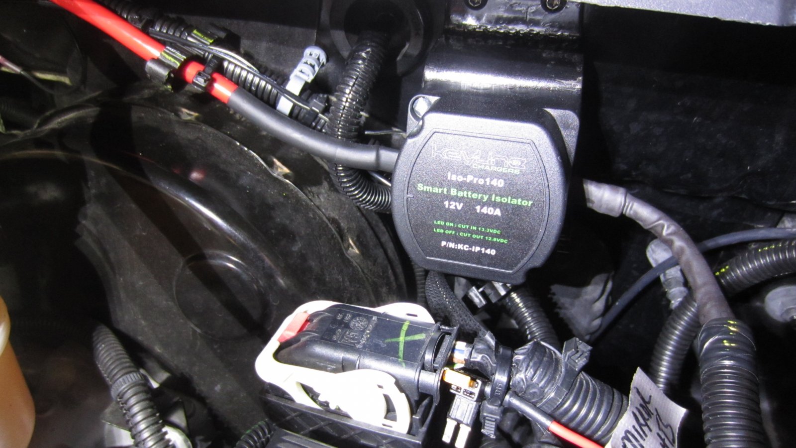

The one exception I mentioned above, is that my truck didn't have the wiring connection for the Isolator Relay. GM must have decided to remove that wiring at some point unless it was for a PPV. What I ended up doing is just removing the relay and isolator from the new wiring harness, and then I bought a VSR (voltage sensitive relay) from Keyline Chargers. I actually like this better than the OEM relay and isolator, it's a cleaner install, and supposedly there is no parasitic voltage draw from the OEM Relay. So, if you decide to do this, you may not want to buy the "Accessory Power Relay", part # 12135194. I have a brand new one if anyone needs it as I can't return it.
Overall, I'm really happy with how it turned out. It's mostly OEM, with the Isolator being the only exception.
When you do this, the new positive battery cable (84355668) has both the positive cable for the fusebox, and the positive cable for the aux battery tied together in the same loom. You'll end up removing your existing positive cable and not reusing it.
If anyone has any questions, I'll try and answer as best I can.
I ended up making a bracket for the Keyline Isolator instead of mounting it directly to the firewall.

This is not my pic, but the parts circled were replaced by the Keyline VSR.

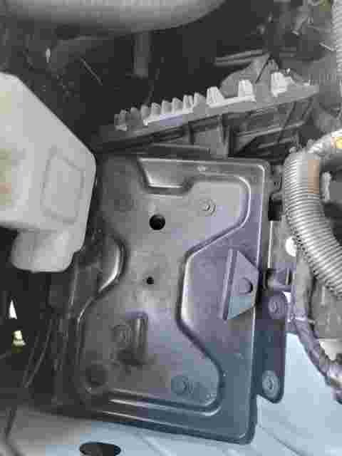

How did you tie down the battery? I picked up a battery tie down block at advanced... But the aux battery tray has no theaded holes. On the one side I "could" run the bolt through, but tightening that up would be a PITA. And technically you need a clamp on the opposite side... Did you guys drill and tap the plate?
You have to replace the existing tray with part # 23231841. The existing tray isn't designed to hold a battery.
My tray is exactly that #... I had to install the battery hold down block before putting the tray back in as there didn't appear to be any threaded receiving point...
