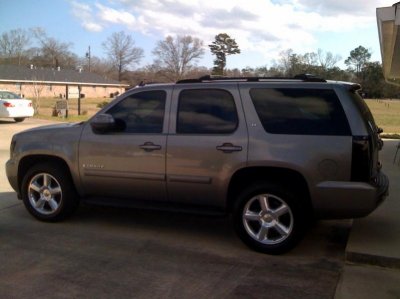

I'm driving an 07 Tahoe with the stock 20's. I want to drop it 2/3. I have found DJM springs for the front and back. Will I need anything other than the springs to get lowered like I want?

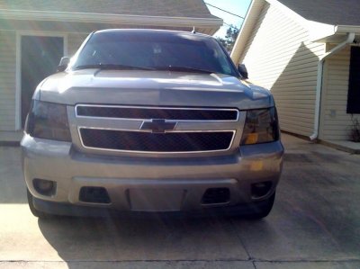

I'm really liking the lights Brad!! What did you do? Is that VHT nightshades????

Thanks for the compliment on the lights. I live in Hammond and there is this place called The Tint Shop. They do great work! Everything they do comes with a lifetime guarantee! My taillights are tinted over with some kind of plastic that they heated up with a blow torch to form it over the lights. The front is just a tint. I replaced the stock bulbs with HIDs so I can still see at night.
