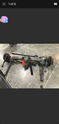

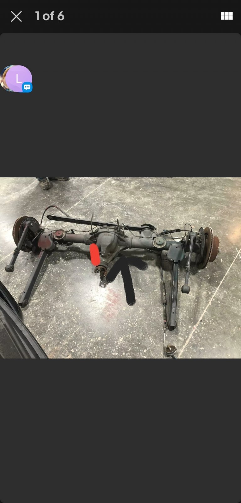

Also got a 90k used diff I'll pick up tommorow to replace this 160k diff

The red highlights the front ears I talked about

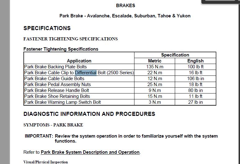

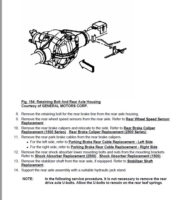

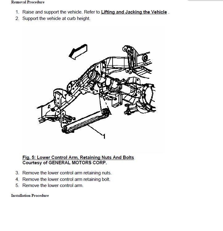

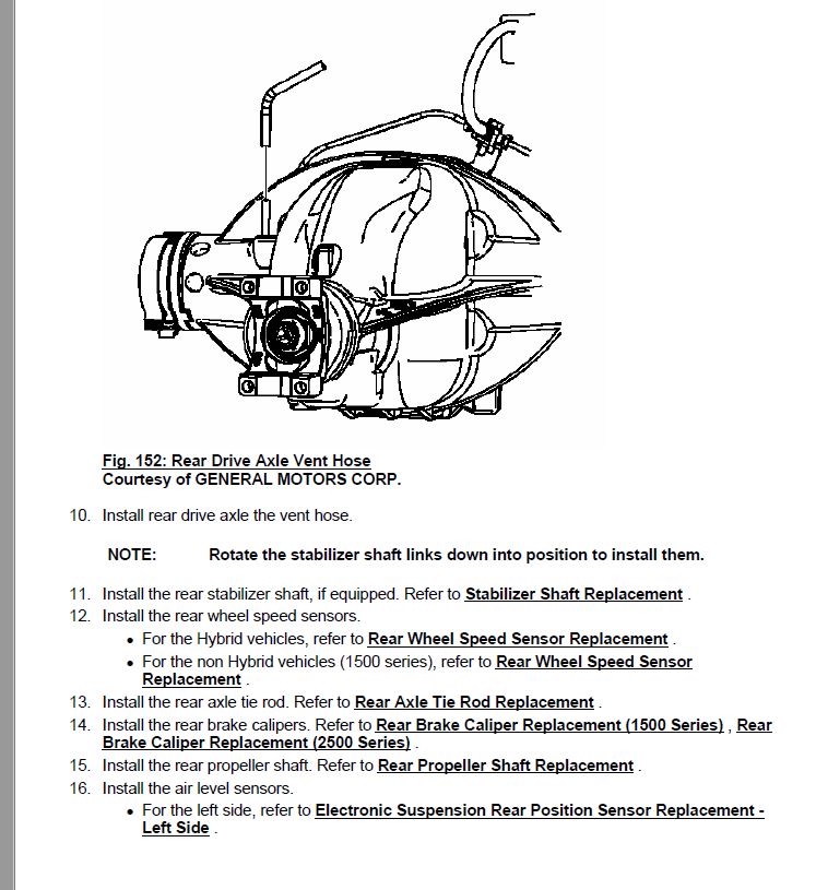

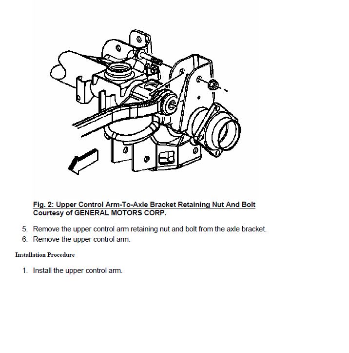

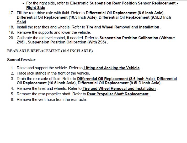

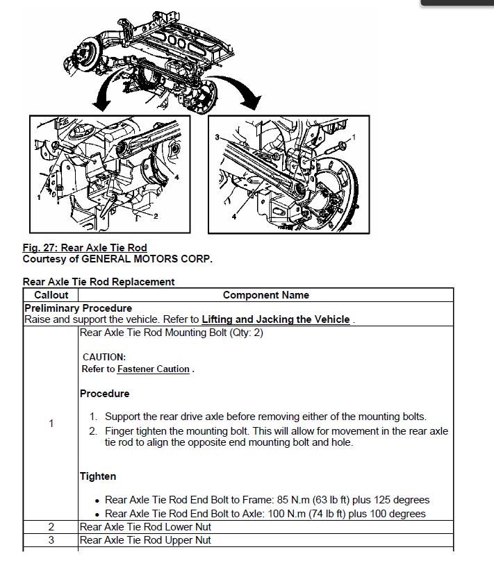

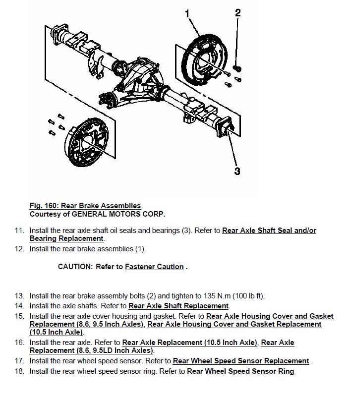

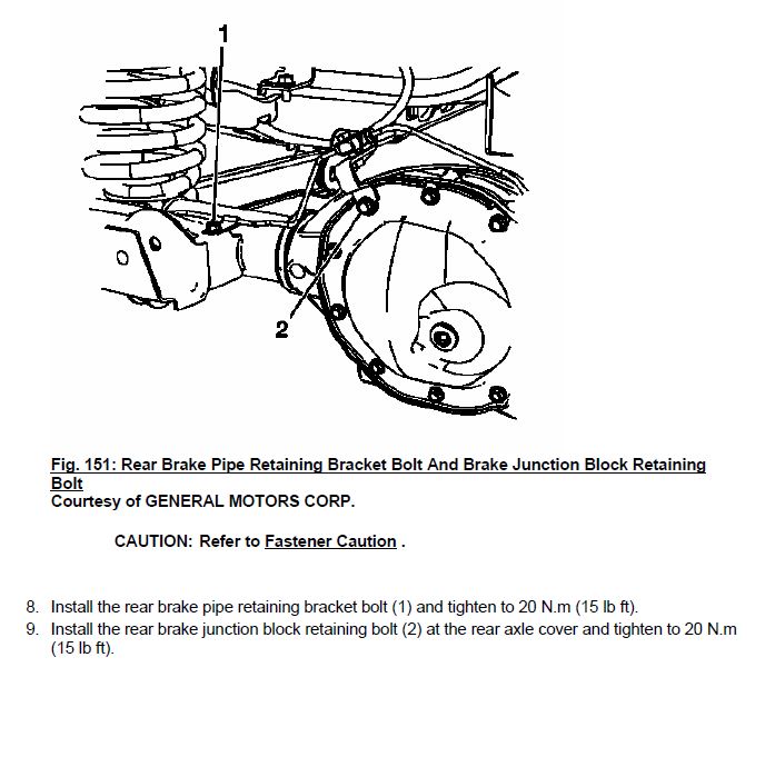

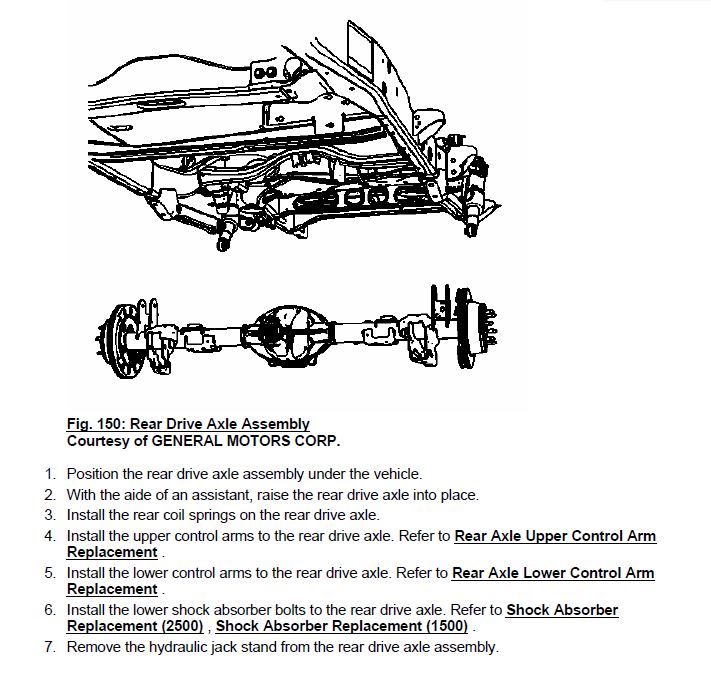

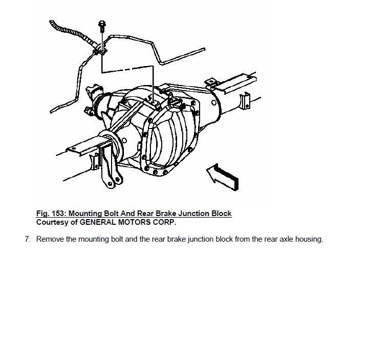

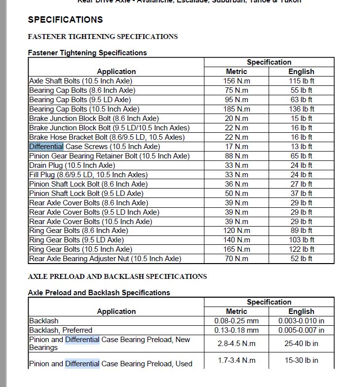

Anyone have the service guide on how to swap the rear end, looks straight forward but just in case and for torque specs
30,698
48,334
there's more but the service manual copy is 11,818 pages and can only be searched manually

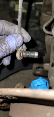

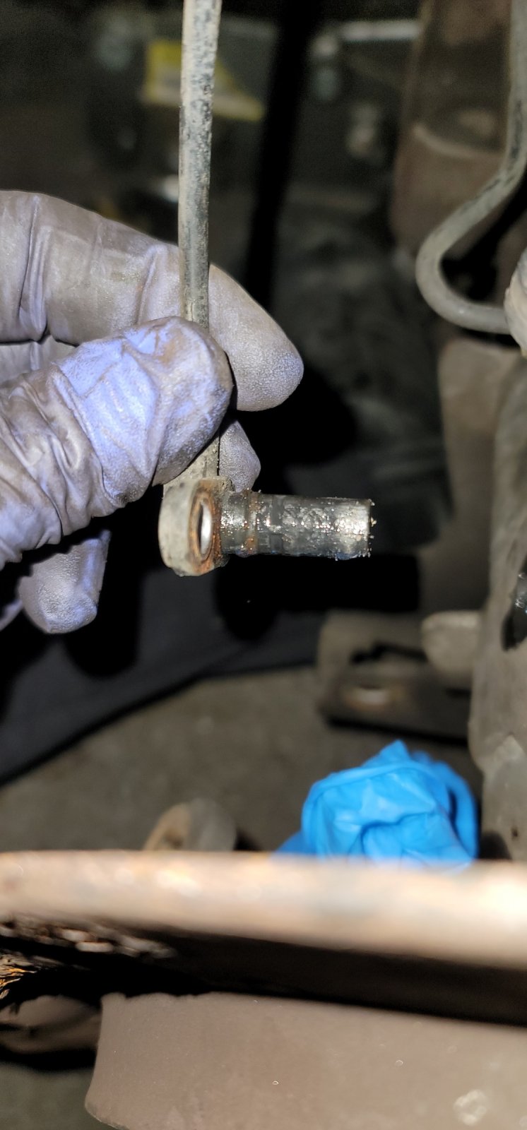

Does anyone know the size of the oring for the rear abs sensors?
30,698
48,334
is yours missing? I am not sure I pinched the cable on my Silverado so I replaced it with a new one I think it came with a o-ring, that retaining bolt was super tight.
I think you can find a multi pack of o-rings in the "help" section at the autoparts store, then just pick one that fits
G
Gerbil21
Nov 17, 2016
20
I'll bring the sensor with me tomorrow and try to find one, the o ring I flat one one side and torn on the other, never leaked but still
Also not done with the swap yet have to get the u joints changed then it'll be pretty much wheels on, fluid and done. Haven't cracked the old one yet either but the abs sensors were coated in metal

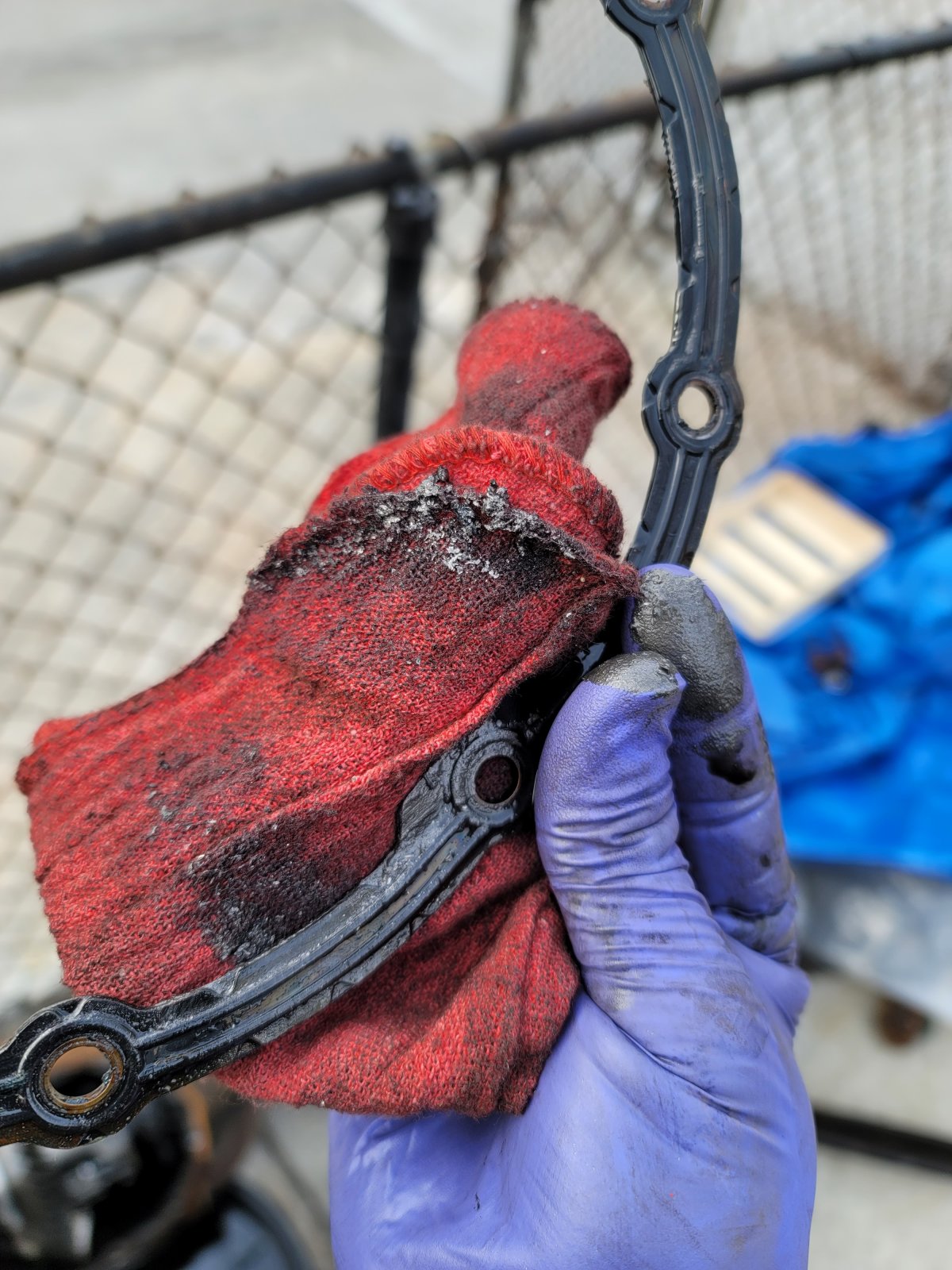

Been busy with work and haven't had much time to work on this but did get to crack the old diff open. Def full of metal, but surprisingly no obvious broken parts besides the excessive backslash as you can see in the video

Forgot to update this but the used diff is in along with all new control arms and track bar, rides soooo much better, nice and smooth and much quieter, no more clunk going into reverse and no more noises.
I did see a few things I didn't like however, someone used a good bit of rtv and it was all inside the diff but it was easy to clean up, also the seller said it was a 3.73 g80, which it is a g80 however it has 342 written on the bottom . When I picked it up it was on a engine hoist so couldn't really see that spot under it.
Are there any tags on the diff that would state the ratio?

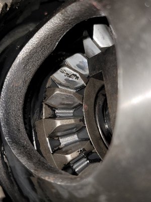

Also I did find one side gear with a little chunk missing. At that point I already had the driveshaft in on the ground and wasn't able to spin it to check the rest fully but so far no nosie.
If I were to take my old spider gears and swap em would I take the washers too or should I leave em?
