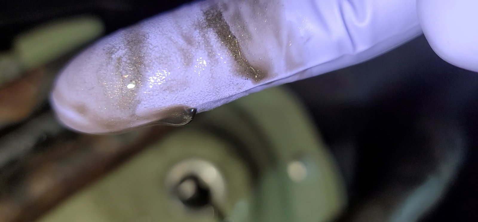

Well I guess I'm getting a bit closer, pulled the rear diff fill plug and found this pretty glitter, def am gunna have to pull the cover soon, can the carrier bearings cause the noise on turns?

Ys they can but I would lean toward the axle bearings. Makes no difference either way though, IMO, when the noise starts and shavings are floating in the fluid, all bearings are suspect and the surfaces of all gears are as well. When the work is done the inside of that housing needs cleaned out really good. Those axle tubes will have shavings in them as well that will mix again with the new fluid if you don't clean them out.

Yea it def needs a thorough going through but at least I can narrow the problem down some what, hopefully I'll have a clear answer when the cover is off, I know I did have pinion noise prior but it was minor and have def drove other trucks with it much worse, idk why it would just go bad so sudden.
Also I suspect the fluid is much worse, what I could touch was kind of low which was surprising however it was also sitting for a day so I suspect what was suspended in the fluid is def by far less than what's settled in the bottom
