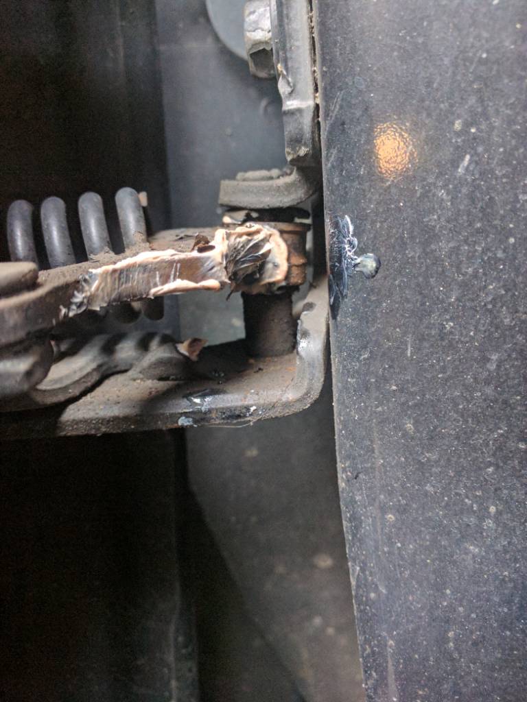

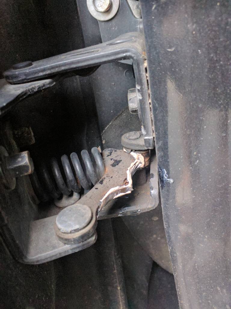

So recently my driver's side front door has been a bear to open and is making noise when I open it. You know, the old rusty car, metal on metal, beater noise when they open the door. Embarrassing to say the least.
I have tried lithium grease to help it, but it does nothing. Any fixes for this? I can see the wear on the metal bushing/roller from use over the years I'm guessing replacing that might do the trick?

It's a common wear/failure point. Happened to me a few months back.
Try hitting it hard with PB Blaster and then working the door open & closed. If that frees it, then hit it with lithium grease. Worked for me.

Mine is seized together. It's suppose to roll I the pin. Makes all sorts of noise and sounds terrible coming from a decent looking truck

Mine does it every month phil, need to get a reg screwdriver in there to get the roller to start moving...then spray the balls off it with white lith so it works in... pain in the ass but you can thank our salty northeast roads....

I was gonna say the same- the roller is seized and that detent arm is sliding (although not smoothly) on it instead of the roller rolling over the detents.
Looking at that side shot, I'd say that roller is roached. This prompted me to see if there were any repair kits for this. I'm glad to see that there are:
https://www.amazon.com/National-Parts-Abrasives-19260063-GMRP03/dp/B00WIFZKY6
Sweet, and thank you for the link as well. I'd rather just replace it than keep messing with it.

I think I will try to pair of vice grips and to break the roller free instead of having to remove the hinge and blazzie blazzie blah blah.
