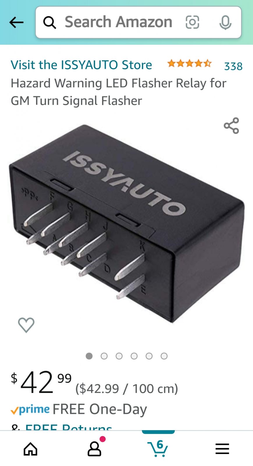

3) The passenger side indicator that does work blinks really, really fast. I did find that I probably need to change the emergency lights/turn signal box under the dash below the steering wheel to an LED one like "Hazard Warning LED Flasher Relay for GM Turn Signal Flasher" I found on Amazon that says works with my truck. Would this fix other issues maybe?
