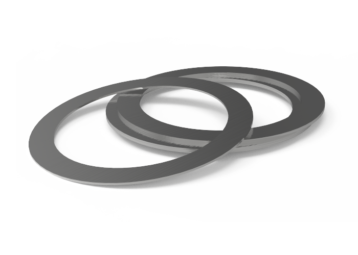

Got the crankshaft sensor today and unlike the picture, NO SHIMS came with it, does anyone have a couple of shims left over that they didn't use?
Much appreciated.

Make one- anything with a hole in it- piece of milk jug....
Are you sure you need one? Measure old and new CPS.
Milk jug is way too thick. IIRC, a standard aluminum soda can is really close to the specified thickness. It'd be a PITA to cut that shape of ring, though.

You didn't mention having shims under CPS, I have only seen one truck that contacted CPS and required shims. Look for a stripe on end of sensor. Use old sensor to determine if you need a shim. No stripe = no shim required. CPS generally work better the closer they get.
