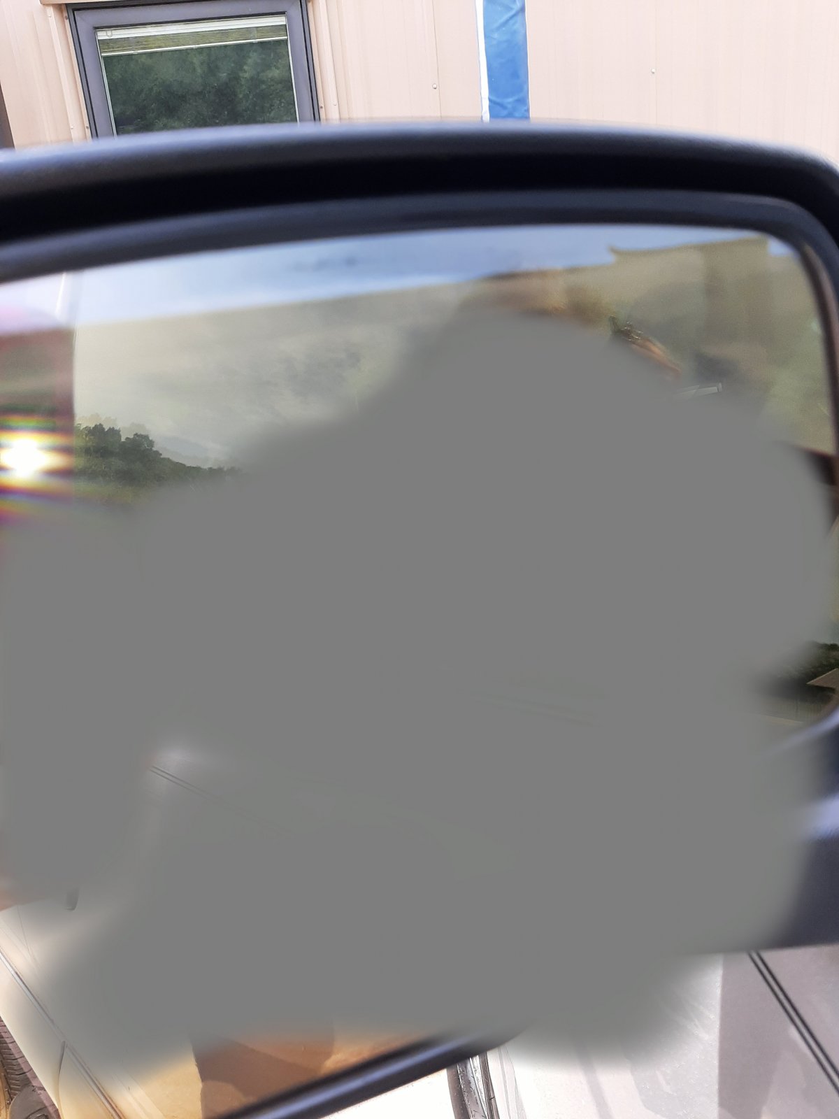

Top of the mirror, looks like film is peeling but I cannot find any edge. It's almost like it's peeling underneath the outpost glass. Open to any ideas . . . .

OK,parts finally arrived. I got replacement mirrors for both sides, replacement mirror switch for the drivers door, and a new console cover. Based on experience, does anyone have any warnings that they've run across when doing similar?

I recommend taking the entire door panel off to remove the trim that holds the mirror and window switches in. There's 2 screws holding it onto the door panel, and you can't get to one of them without breaking the nub the screw goes into--if you don't take the door panel off. Quite a few of us have been there.

I looked at the mounting inside the mirror housing, and the replacement mirror. I see the small latch tabs that hold things in, but was wondering - do they just pull straight out and release, or should I use a small long screwdriver to reach in and release a couple. I really don't care about the bad glass that's in there(other than having to sweep it up), but don't want to damage the inside assembly.

Wouldn't hurt to use a screwdriver to loosen some of those "fingers", then pull it off.
