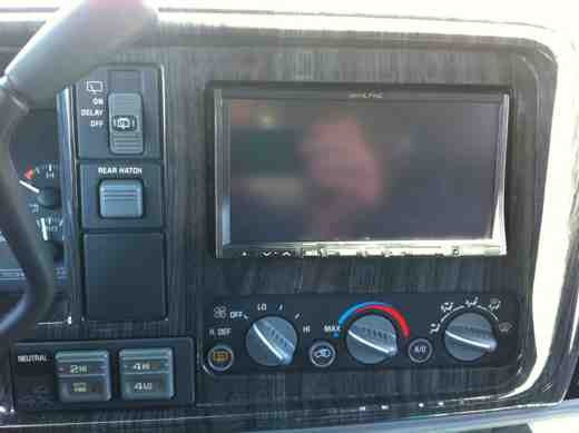

You are gonna need more than a dremel. Lots of hand sanding to make sure you get that plastic insert to fit right and square. I just finished mine and it was very tedious. After with primer....
It's now off getting hydro dipped. :)

Use the dremel to cut the majority of the insert out. Then hand sand to get it perfect. Keep trying and test fitting as you go. Sand just enough to keep going so you don't have to fill any gaps with filler. I ended up just glueing the insert piece in with some gorilla glue from the backside. It is very solid.
Cutting the inside of the dash out is pretty easy. Just really messy! Black plastic everywhere. And just becareful when you cut out at the bottom corner where it says in the instructions. I was very careful not to cut the tab hole out but it still broke free.

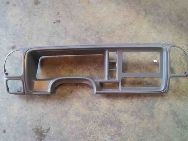

update : 4 cutting wheels later (appearently they dont like being binded up) and about 45 mins and this is what i got NOT DONE yet but its starting to come together ill say another hour or so of just sanding and cutting and i should have a good base

Here you go....
Still have to install the radio trim ring but it turned out better than I imagined. The hydrodip is amazing.
