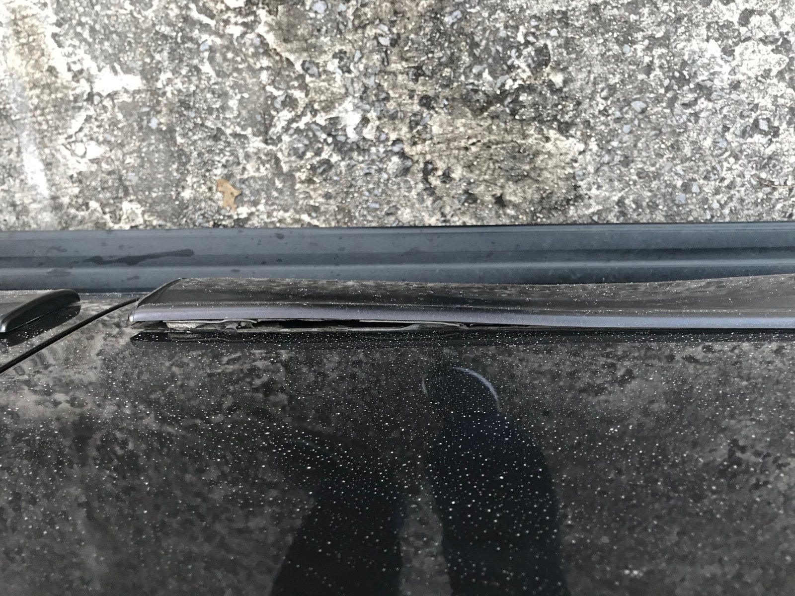

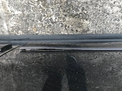

I have noticed that the drivers door at the rear is sticking out a bit at the rear of the door. I guess that I would have to remove it completely to refasten it? What is the best way to remove without damaging the paint or moulding?
Funny you say that, mine is the same on both sides! Almost look like somebody tried to pry it off from that spot!

I had a 2016 Denali PU that did the same thing it was refastened under warranty but I have no idea how they got it off or what they used to refasten it with. Here is a pic of it. I have not bothered to do a pic of the ** door yet but it looks about the same. ** is just my beater daily driver but I still like to keep it in good shape...

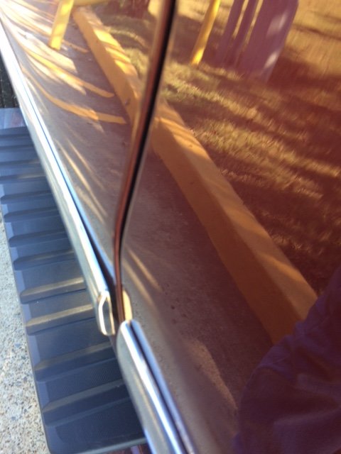

2010 LT Tahoe: So from reading thru this post i will be using fishing line and Turtle Wax remover and 1" 3M exterior tape.
Do to it being winter and not having a heat gun but placing in the oven for mmmm 20 minutes at 100 degrees? Not sure if it would be hot enough but would evenly disburse the heat? Recommendations?

You’re going to need some heat for removal to make sure you don’t take any paint with you. Do you have a Harbor Freight? They have heat guns for $10 on sale. If not how about a blow dryer?
