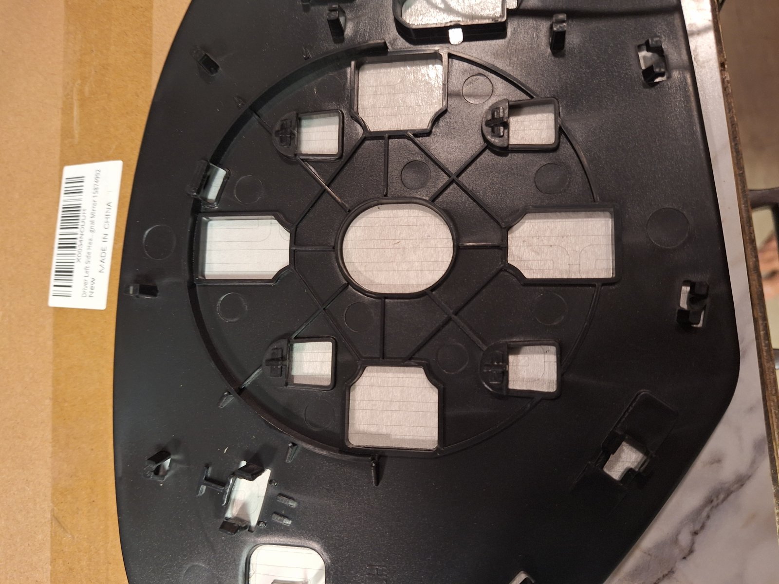

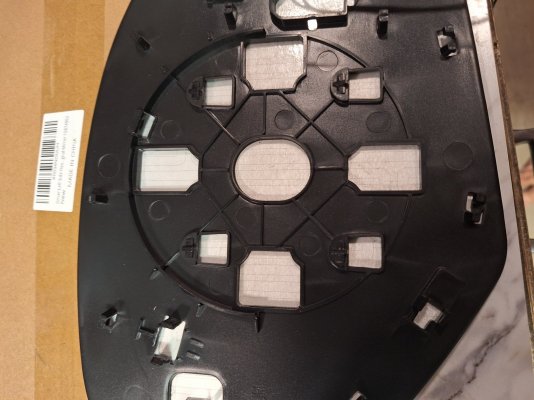

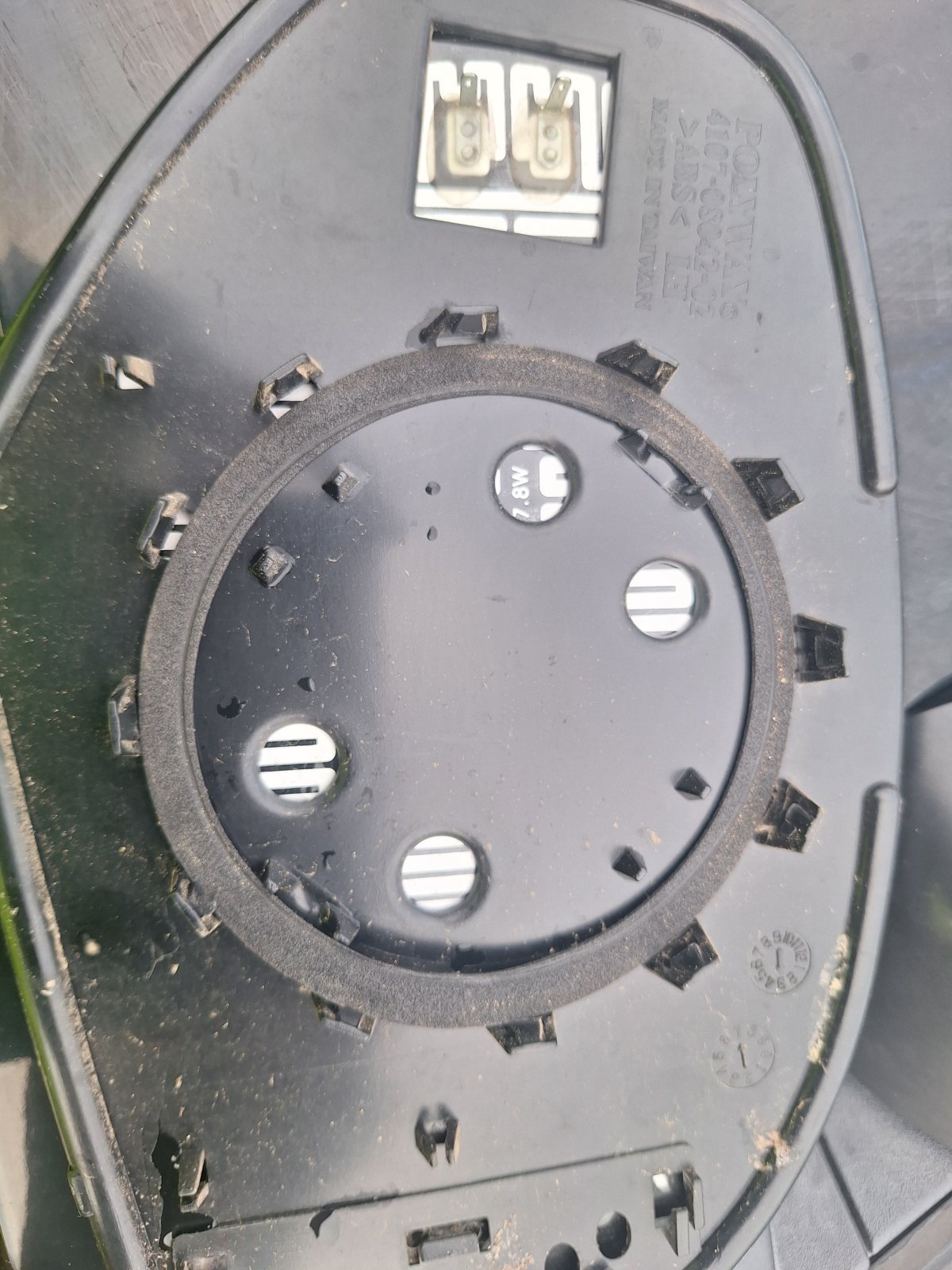

Im trying to replace the mirror glass on my 07 tahoe ltz. It has the heated,turn signal option. I got one from Amazon and it has 4 little tabs that slide down to lock in place. The issue is mine has a circle of tabs that just push into place. I've looked the internet over and they are all the same as the one I got from Amazon. I see nothing that looks like mine. Any ideas what I'm dealing with?

All the gm mirrors ive taken apart look like your original. That circle of clips ‘clip’ onto the motor in the mirror. The second pic looks completely different from a gm mirror
Not that this helps but i believe thatsvthe wrong insert. Check ebay and get a full mirror maybe?

I just went to google and i see what you are saying they do all look like your replacement. Was there a ring in your box may that clips in there withe the original looking clips maybe

My factory mirrors had the 4 tabs.
There is a ring, but it attaches to the mirror with the 4 tabs.
Edge of ring is facing actuator, which snaps on with 4 different tabs iirc..

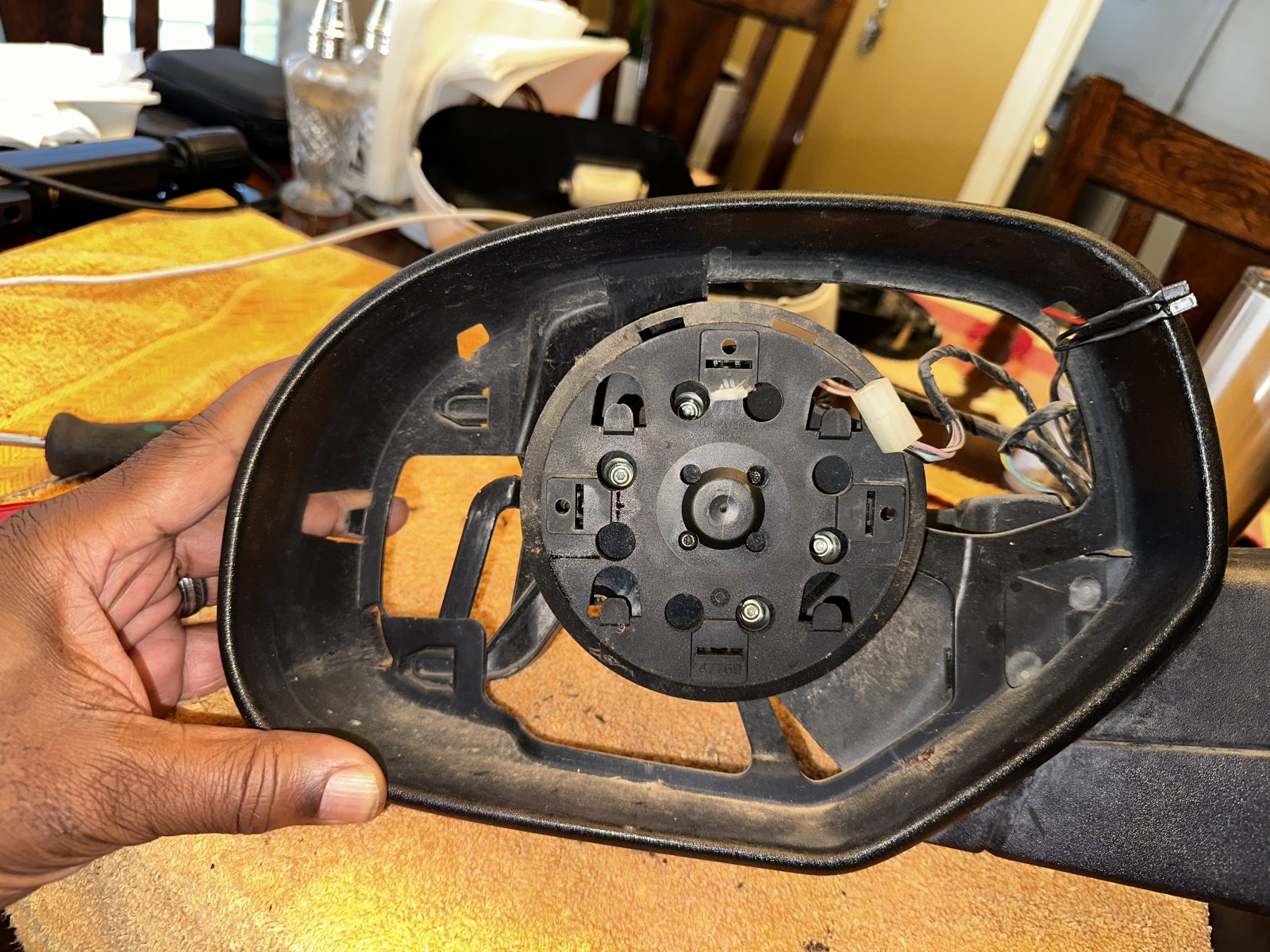

@_GMAN_ 's photo below
You can see the 4 upward tabs, and the 4 locations with a small hole over a slot (clocked 90deg from tabs) is where the actuator snaps in on the back.

Ok, my mirror assembly looks nothing like that. On mine you can see the two motors that move it and there is a open circle around them.

I remember pushing the mirror all the way to one side and releasing the circle of clips with a screwdriver until enough were discon to just pull it completely off….

I searched all years and they look the same as the new one I got. Im thanking maybe the whole mirror was changed at some point but it's odd that you said the ones you've been into look like my original.
the "original" one you pictured is aftermarket, it is like a nbs style which is where mr gamboa got confused
that being said do you have a picture your whole existing mirror housing?
I ask because how the rest of it is designed depends on how much you need to spend to get a correct mirror
for instance if the "cap" is painted to match and is a oem type then you can grab any used oem DL3 mirror, install it and slap your color matched cap on it and you are good to go.
OR... if the motor inside matches up with oem on the backside and just the front is different, then you can just buy a oem motor and be good to go.
