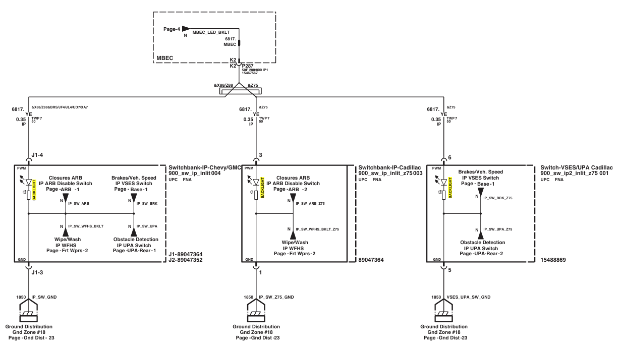

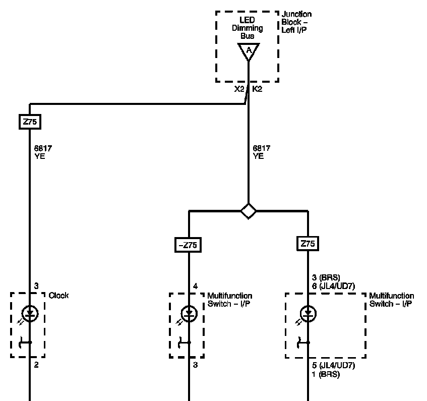

Some dimmer lights work? (Light switch, 4wd, HVAC) but not radio or multifunction switch?
I would check the connectors on the MBEC..
The automatic HVAC controls it's own dimmer, gmlan must tell it what brightness setting it should be.
The diagram above shows the Manual hvac connected to the same circuit, but yours is auto.
I'm not sure which plug that is.. Might try and jiggle them, expecially any plug that has a yellow wire..

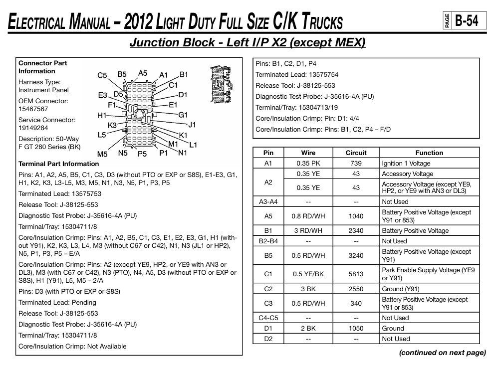

Connectors might be located at the left I/P junction block..
mikez71
Mar 9, 2023
3,334
4,137

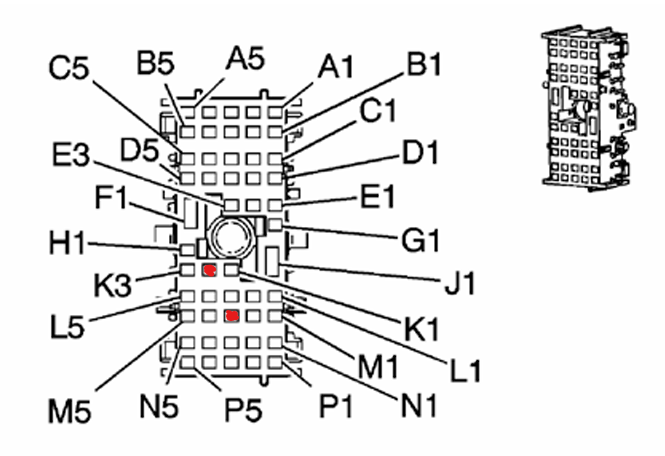

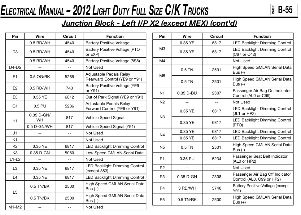

Apparenty MBEC = Left I/P Junction block...
(Not to be confused with the I/P Fuse block which is on the left side of dash/instrument panel!)
Best I can tell the red pins should be for your radio and multifunction switch panel..(M3 and K2)
Not sure if the problem is there, but it might be worth a shot to inspect the connector, which appear to be on the backside of the unit.
