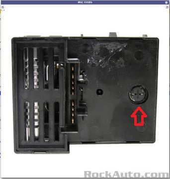

There's a backlighting bulb in the switch, accessed from the backside of the switch body.
It looks like this:

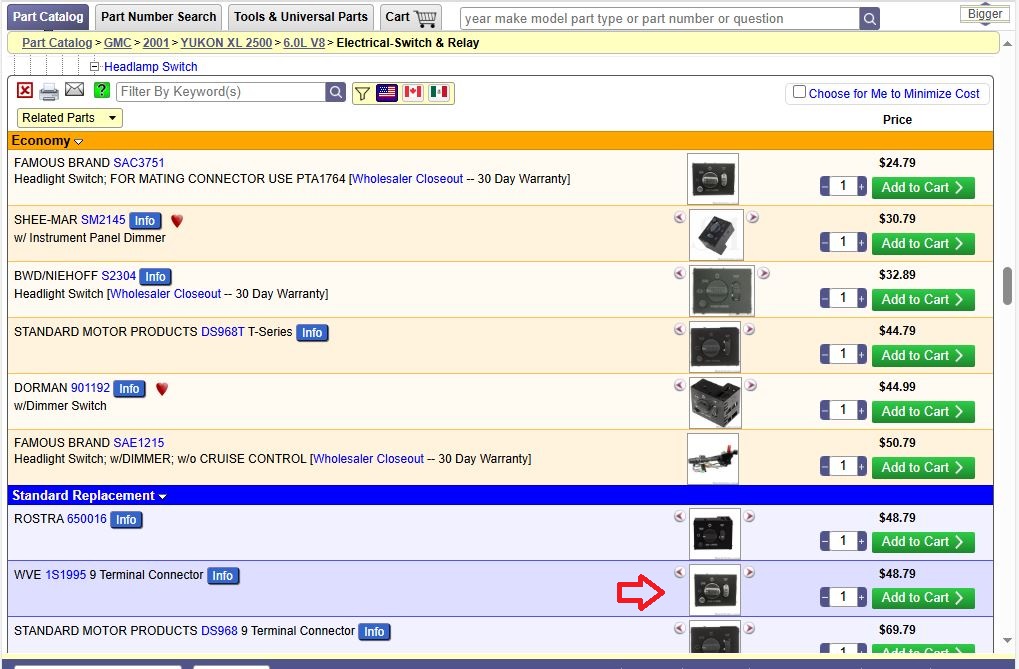

I'm familiar with the switches and the bulbs since I've re-bulbed mine.
I found the switch on Rock Auto, then there are pictures both on the multi-listing and the same pics when you select the part. I knew from experience where the bulb gets inserted, but I don't think RA has the bulbs available; they're somewhat of a specialty item.
