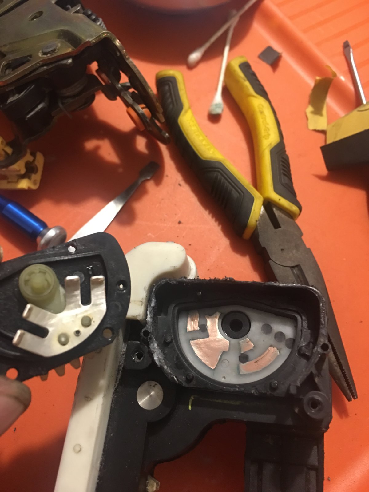

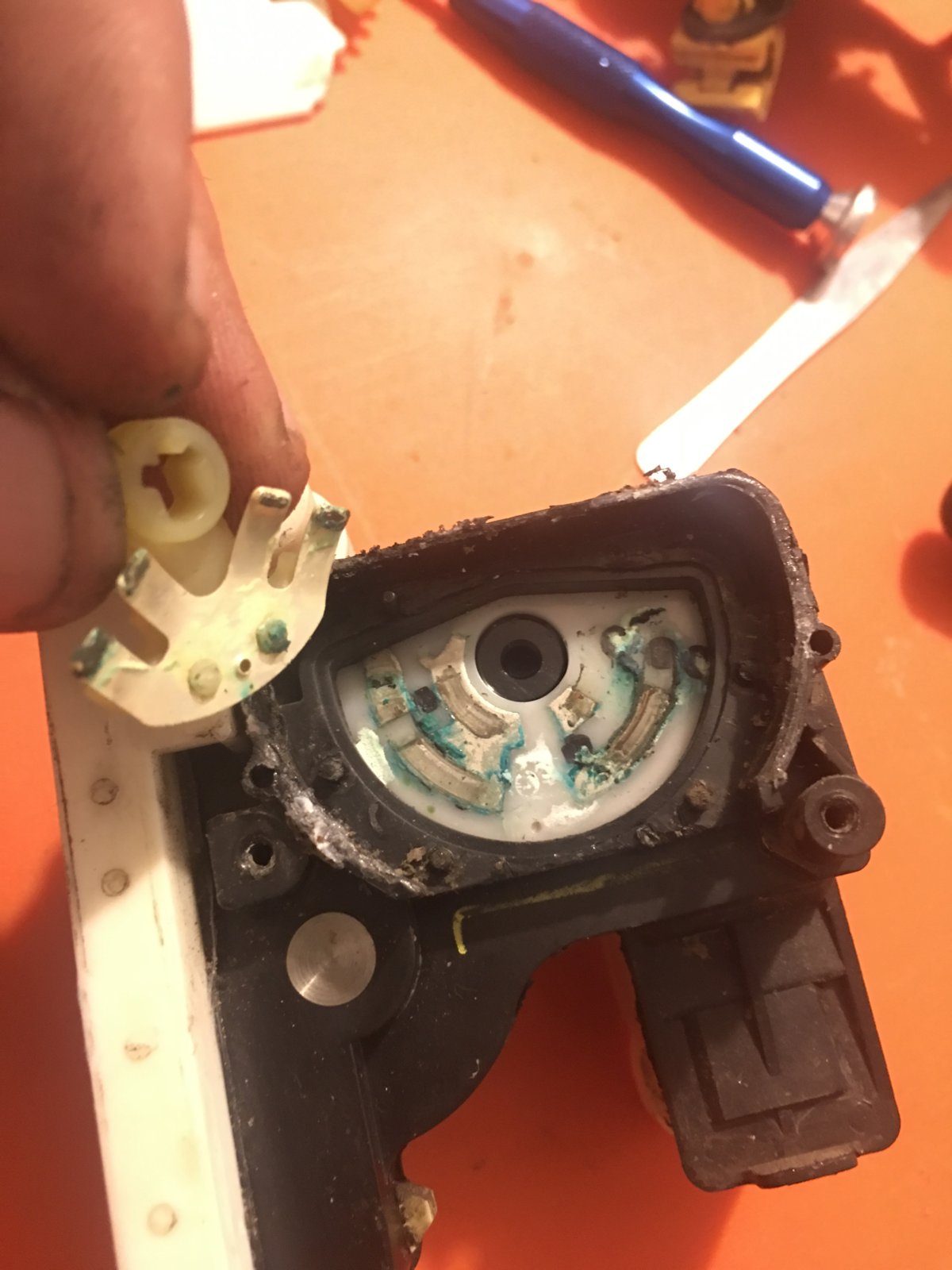

The Door ajar switch is in the passengers door latch assembly. Try from the passenger seat, cycle the key on engine off, and with the radio playing, turn the key off. The radio should still be playing, then open the passenger door to see it the radio cuts off or not. If not, definitely seems like you may need to disassemble and clean the corrosion from the switch.
15D0EAB3-EAF6-4599-BC2C-E0156B81FE8E.jpeg 26B71B74-C5BF-4FB4-8341-178BF88ECF1B.jpeg

I just wanted to update everyone about the interior light problems I have been having. The problem was that the interior lights stayed on or off off when doors were opened or closed. It seems like a random issue most of the time but happens more in the winter.
Well as it turned out I finally found one of the problems. Possible the main issue. It turns out that the door latch for the rear passenger door was sticking because some goof put 30 weight oil or something in there to lube it up. I am going to take out that latch today, clean it up with electrical contact cleaner and take some pics if needed. Hopefully I don't need a new latch.
