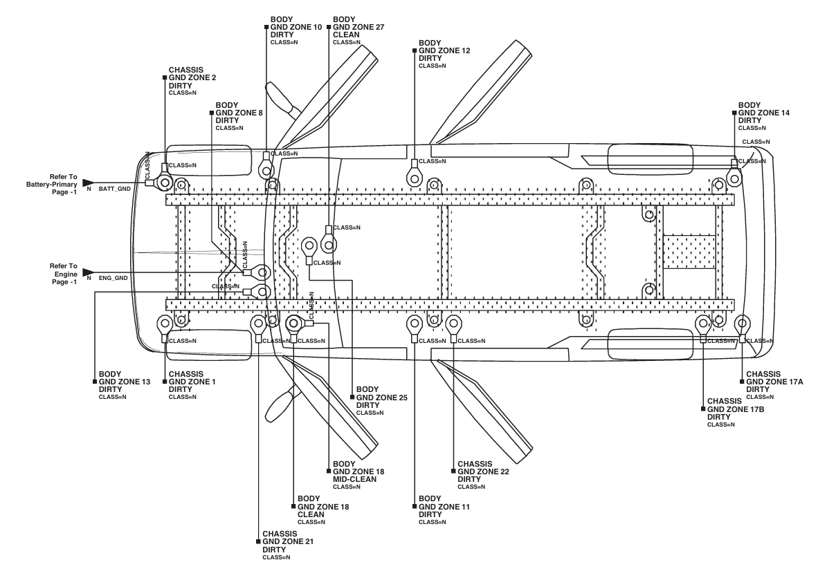

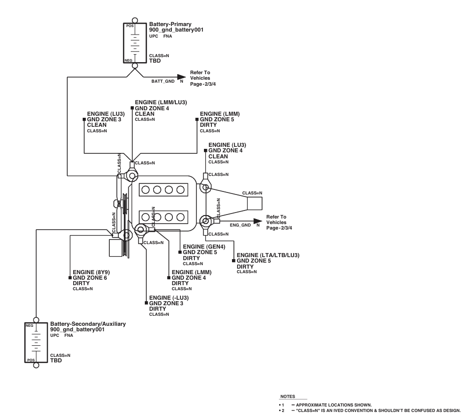

Approximate diagram, but Fless' list details the specific location better.

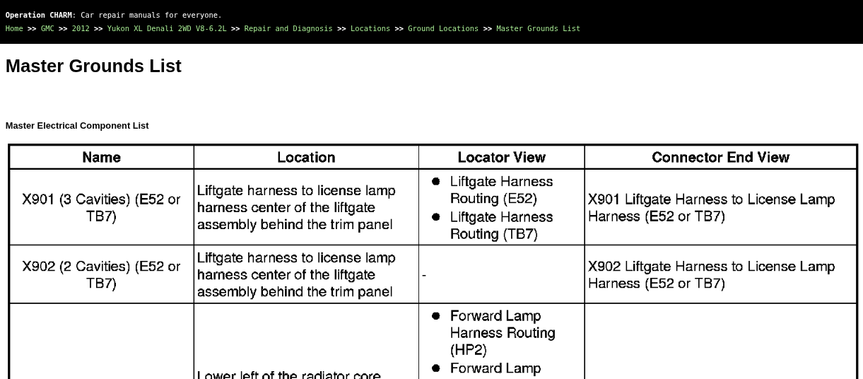

A full list can be found on www.charm.li. See the link below, but know that the CHARM site is being a bit finicky today and you may get a "bad gateway" message. Just keep hitting the link.
Double-check that I got the vehicle right -- there is a similar section for the AWD XL.
You should see a description grid like this:

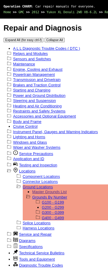

You can also see a listing of the ground locations by using the green links at the top of your browser. Click on the one just before "Master Grounds List" called "Ground Locations." Many grounds listed there will have a diagram of the location.
Click on the "Grounds by number" link, select your ground, and open the link:
