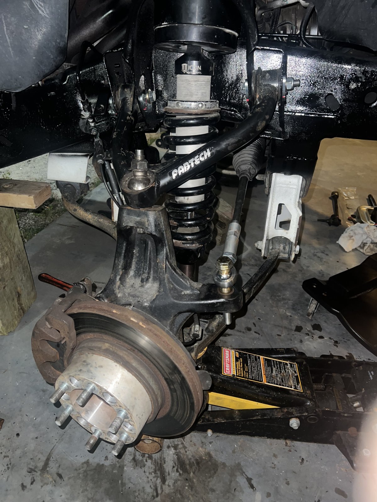

On the rear I have used the Fox 2.0's paired with Moog 81069 springs and Fox 2.5 DSC's paired with the Dobinsons C09-037. Both worked great on and off road.
I run the C09-037 due to the constant extra weight I am hauling (spare tire carrier, cargo box, etc.) If you are not carrying the extra weight the C09-045 are recommended.
It took a bit of trial and error to get a combo I was happy with, but I highly recommend this setup.

I got my fabtech arms off amazon when they went on sale I believe they were like 500-550$ but usually 600-700$
Also a side note my uca came off a 2018 Silverado so if you happen to find a cheaper deal on the fabtechs for the
14-18 years they will work on your Tahoe no problem. I also got my icon coil overs used off a 2019 gmc at4 and they worked no issues the at4 are 2” higher from the factory so instead of being 3.5” they were more like 5.5” coil overs so with the leveling kit on them I was able to pick my lift up to 8.5” give or take
As far as the settings I tried all the settings of the 6112 and was not happy with the ride at all I felt like I was being beat to death and my new Monroe’s I replaced them with felt like I was riding on a sponge way too soft. Before I would hit this one set of doubled up train tracks every week going to work and I would slow down to 40 with both hands on the wheel and felt like I was dancing left to right on the road where after I did the coil overs and control arms I hit that biotch going 75 driving with my knee sipping coffee and ain’t skipped a beat she stayed planted the whole time due to the extended downward travel she gained it felt way more controlled then the previous setups. This was also with the upper 2” and lower 1.5” leveling kits installed I’ve Baja this Tahoe down the beach and on the side of the road a couple times going 60-70 and she just soaked it up like it weren’t shit!
Note the fabtech arms require you to ream your spindle out some for the tapered pin in the uniball but that’s no big deal but may be a issue if you ever decide to go back stock which I doubt you will once you see how big a difference it’ll make. I weren’t spending 50-100$ on a reamer bit I ended up using a drill bit and “wollowed” the hole out a lil at a time until I got it where it needed to be. If your worried about this you could always swing by a machine shop and they could help you out with this part if you feel uncomfortable but it’s really not hat hard at all
Also I highly recommend getting locking alignment cam plates so you never have to worry about knocking your alignment out of wack once you get her all together and get it aligned the stock slider ones SUCK
to be honest I don’t remember the last time I’ve even greased these bushings on the control arms! Once in a blue moon i spray some lubricant in the uniball joint but I ain’t even done that in a good while! I got them June of 2021 and they were USED when I got them and I’ve put probably 100,000 miles on them since then and again zero issues with the joint or the bushings and they don’t make a sound! Before the RC arms I had would creek and squeak and would drive me insane
Don’t let the reviews on those uca scare you off of them there’s one guy with a blue truck who said they were junk cause the bolt broke on a dirt road but from the looks of the pic he obviously diddnt ream the spindle to fit the tapered bit into it so it had too much leverage and wasn’t fully seated into the spindle (operator error) my buddy has these same uca in his Silverado and travels all around nc he’s had em since 2019 and never had one issue out of his either he’s the one who put me on to them
