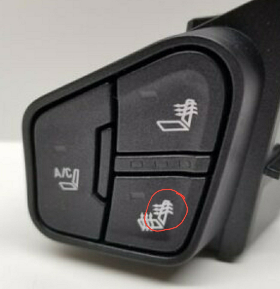

What does the pic on the button look like? I know on my heat buttons, one shows just the back and the other shows back and bottom.

Hi Coach, I agree with gooffey.
The wavy lines should show the back also. How about your's?

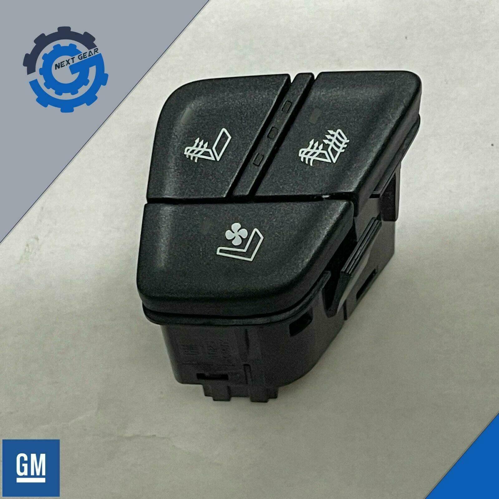

The top right and bottom right buttons are for HEAT, as in electric heating elements, you have your choice between butt WITH back or just back.
The AC seats, which they no longer called AC at some point, in my 2019 just blows cool air through the bottom seat cushion. You'll notice that your bottom seat cushion has air holes in the leather, and trucks without cooled seats will have solid leather bottom seat cushions. The backrest leather never has the air holes.

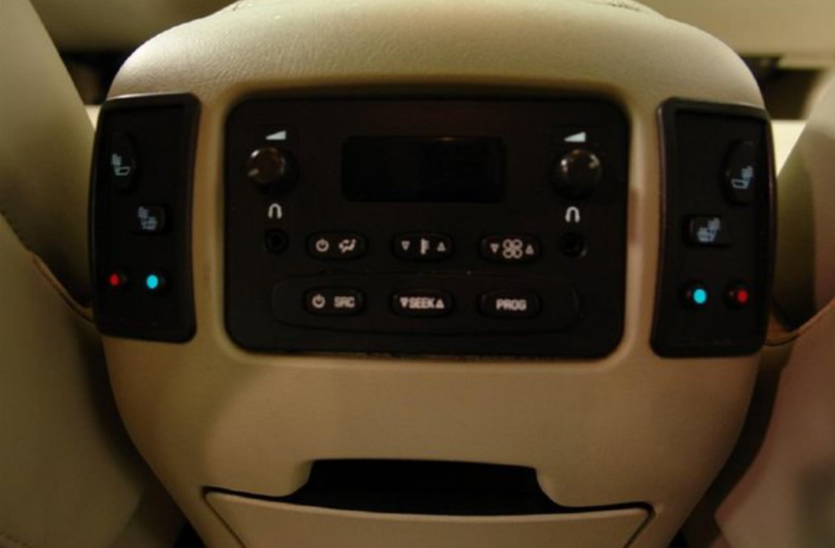

GM started the cooled seats in the 02-06 (NBS) Gen Escalade. Some of the Platinum trim had an option for BOTH front and rear seats cooled. The next Gen full size SUV (NNBS) from 07-14 lost the rear seat cooling option. GM ditched the cooled seat option in 2011 and went to fan only or ventilated seats due to cost and … the EPA gave them gas milage credits for lowering the milage from keeping the A/C off for ventilated or cooled seats.
If you have perforated leather seats in front and/or back you can add a TED to make them cooled. Why do this? Owners of dark, sun soaked trucks with dark interiors that live in states like AZ or FL it’s a godsend.
05 Platinum rear seat console with cooled seats switched on
