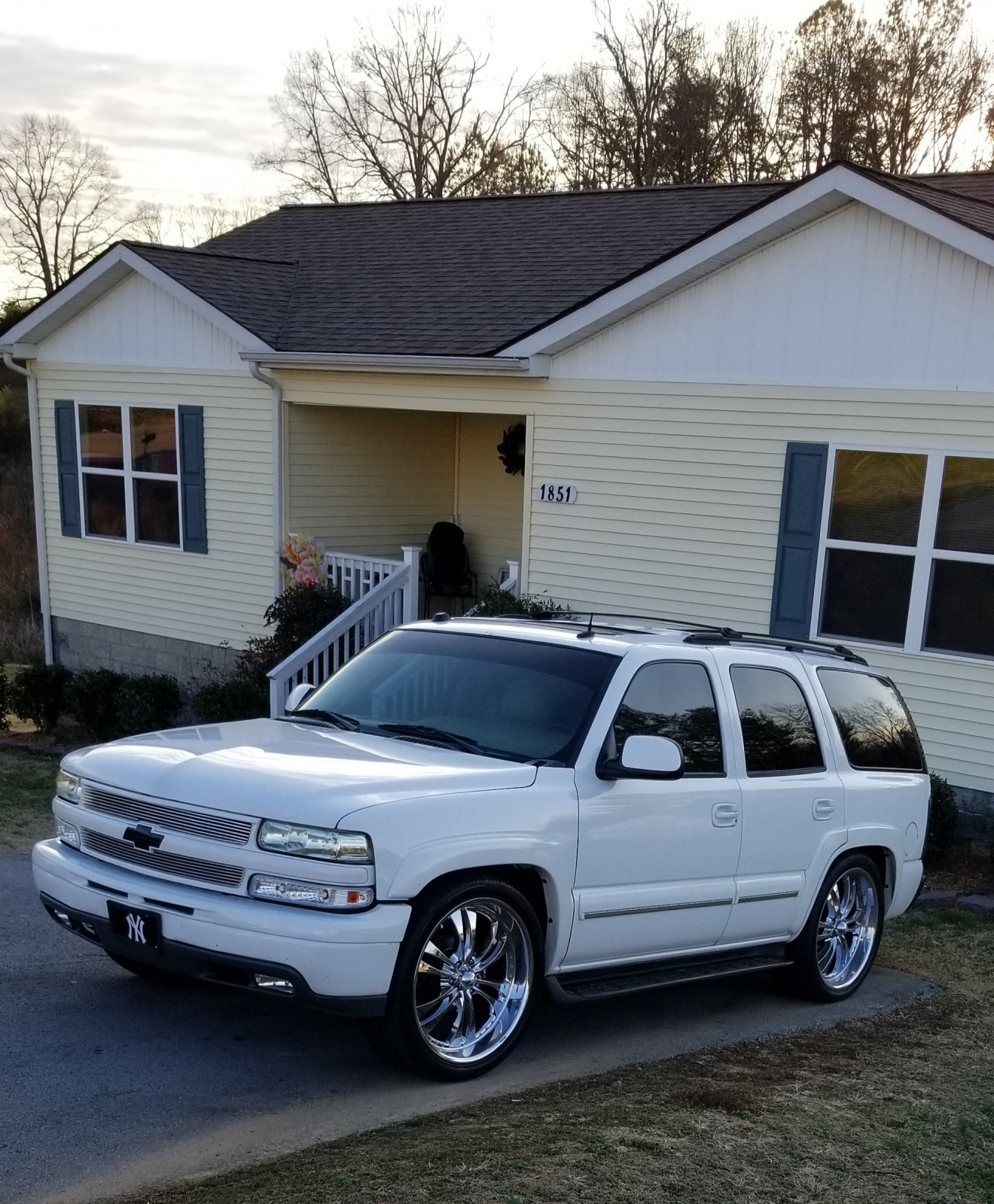

I think I want to go lower than this.
45,011
Yes that's what I been trying to figure out. I kno I'm good now just wondering what I'd need if I went lower. Which I may so I may do my uppers with the bushings an slam it
Since you're replacing the arms, getting the offset bushings will probably be your most logical course of action. At your current drop, they may OVER correct and give you positive camber, but there should be enough adjustment in the slots to align it. Then, if you go lower, you'll already be set to align for that.
