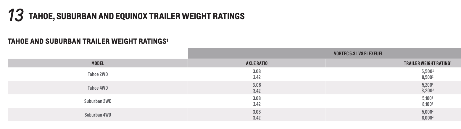

I think the 1500 is closer to 5k #. At least that's what my hitch says and google confirms.
If your trailer is 6500# you're already considerably over the rated tow limit. Which personally I'd be fine with for relatively short/slow trips, but if you're towing frequently I'd spring for the 2500. You also get some extra power with the 6.0. Or look for a Denali trim or Escalade with the 6.2.
NOSOK
Oct 13, 2020
123
170
Colorado
Actually looks like it can be up to 8k # but it's dependent on the rear axle.
https://my.chevrolet.com/content/da...s/MY14 Trailering Guide_1113.13 - Equinox.pdf

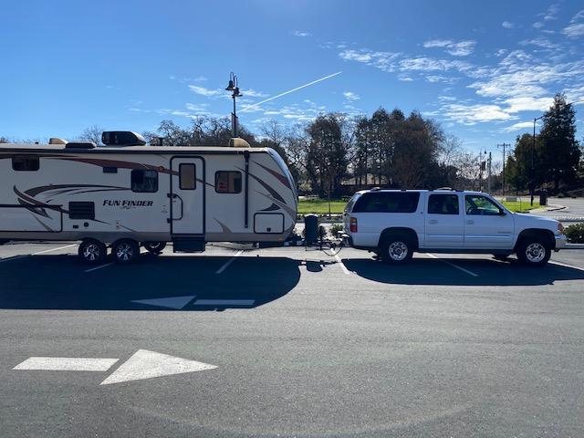

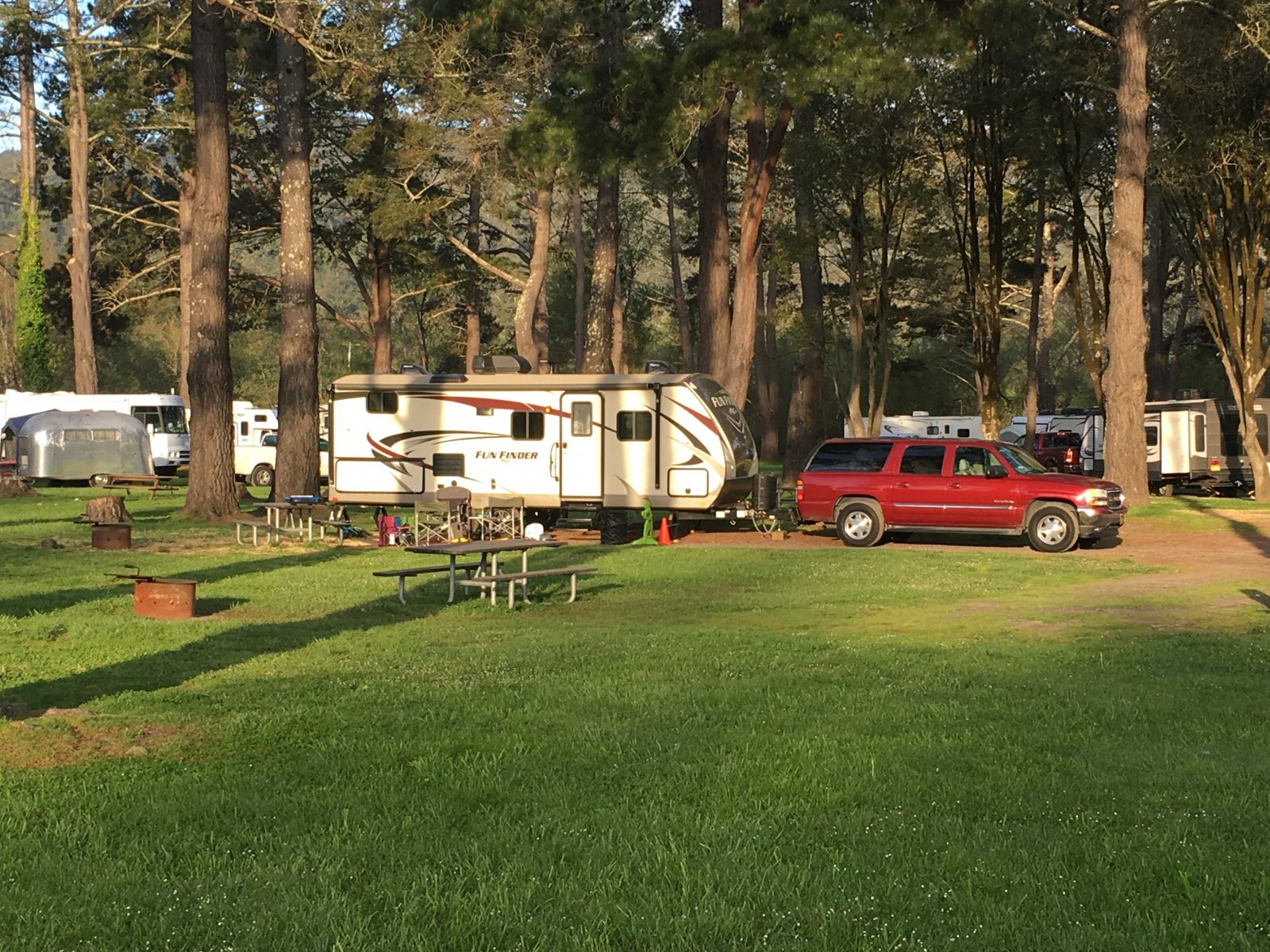

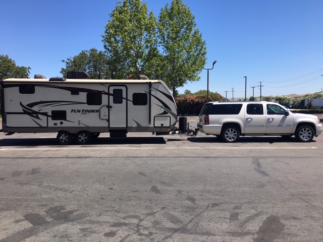

I had a 2005 Yukon XL 1500 2WD when we first purchased our 28ft 5,500lb (dry) 6,700lb (loaded) TT and and it was not a fun towing experience on any grade. Seemed to do fine on flat ground but any hill and we were down to 25-35MPH with the trans trying to drop into first. Had to replace rear axles during 2nd year. Had a TruCool 40K on it and temps stayed in acceptable range.
Looked for a 2500 to replace it but eventually settled on a 2012 Denali XL with tow package a couple years ago. I put a TruCool 40K on it and no other mods and it has been a very capable TV, although the rear axle is still the weak point IMO and my family is still growing (3 kids plus a dog). The 6 spd transmission helps and the 6.2L (great motor, minus AFM) can generally hold speed up most grades. It doubles as my wife's DD and she loves it. If we had to continue to use it to tow I think it would be fine but I'd expect the rear axle, autoride shocks or trans to wear prematurely, plus the gear ratio is still only 3.42 and it's AWD. The Integrated Trailer Brake and auto leveling is nice. But I kept looking for a 2500 I could use as our main tow rig.
Finally in January I found a low mileage 2005 GMC Yukon XL 2500 4WD with the 6.0L and 4.10 rear axle that wasn't exorbitantly priced so I pulled the trigger on it, had some significant maintenance completed and we've made one trip of a couple hundred miles and it did FANTASTIC. Maintains speed up grades with no problem, feels steadier and more solid all the way around. SO far I'm running it stock, did upsize (slightly) tires to 265/75/16 (from 245) and added Timbren jounce stops in the rear.

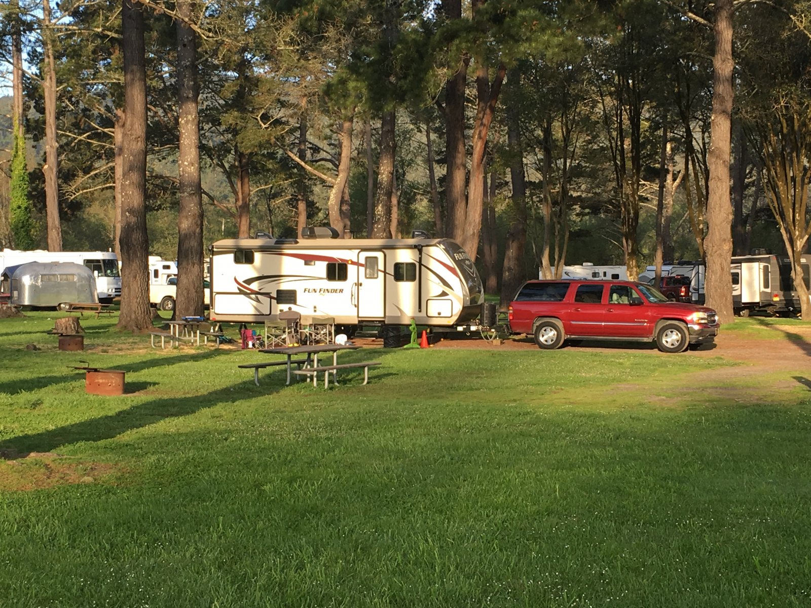

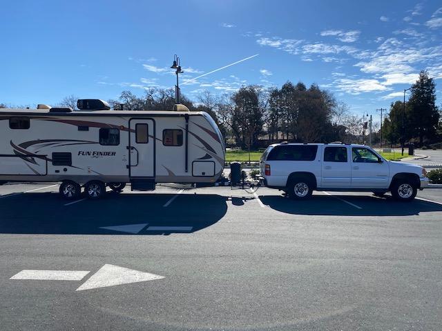

View attachment 272505 View attachment 272506 View attachment 272507
The 6.0 and 410 axles are a great match for your needs. The 6.0 will rev and has good low end torque. I loved my 2004 Avalanche 2500 with the 8.1 and 410 axles. It would tow ANYTHING...all the way to the gas station.
