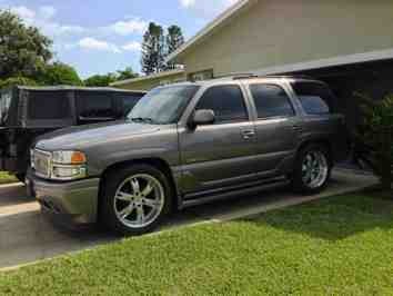

I ended up with a 2005 denali and love it!! I am running the Eibach 2/3 drop, and sway bars. Happy thus far... Could always be lower.
