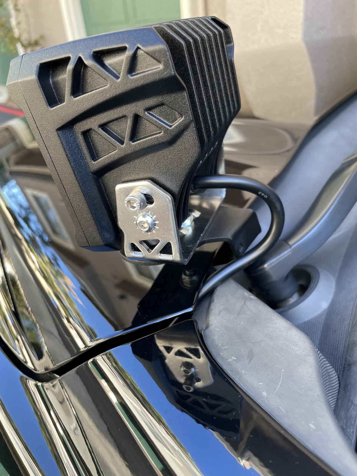

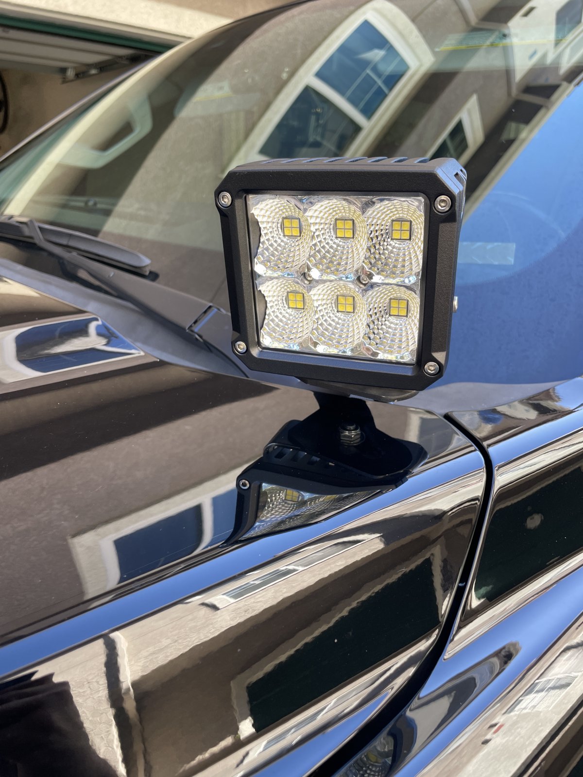

I got some not rigid brand 6 LED square pod lights and decided to grab a bracket from a custom shop up Texas and wire up some 3000k LED spot lights. The harness was too short from pod to pod so had to extend it, I accidentally touched the spring on the hood to the ratchet haha that was fun, over all I’m happy. Eventually I’ll get something a little bright with a wider beam

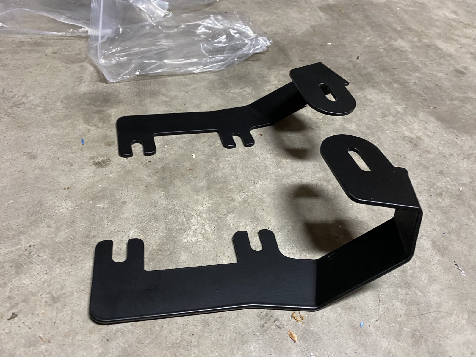

I scored a set of brackets on Amazon while they were available. I haven’t decided what I want to install yet, but a least have the ability.
I have the same brackets $35 shipped off the eBay. See if they fit your Tahoe or yukon

That was a $30 Amazon led set of ditch lights m, replaced the wiring harness and lights with some that cost $120

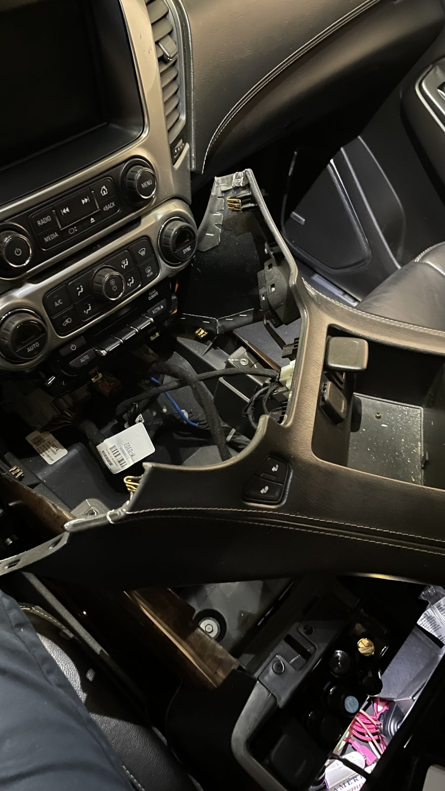

Just spent the last hour removing center console breaking the cigar light plug back end, drilling it out feeding wire with switch through.
Over all a fun install! Can’t wait to use them out in Arizona next week

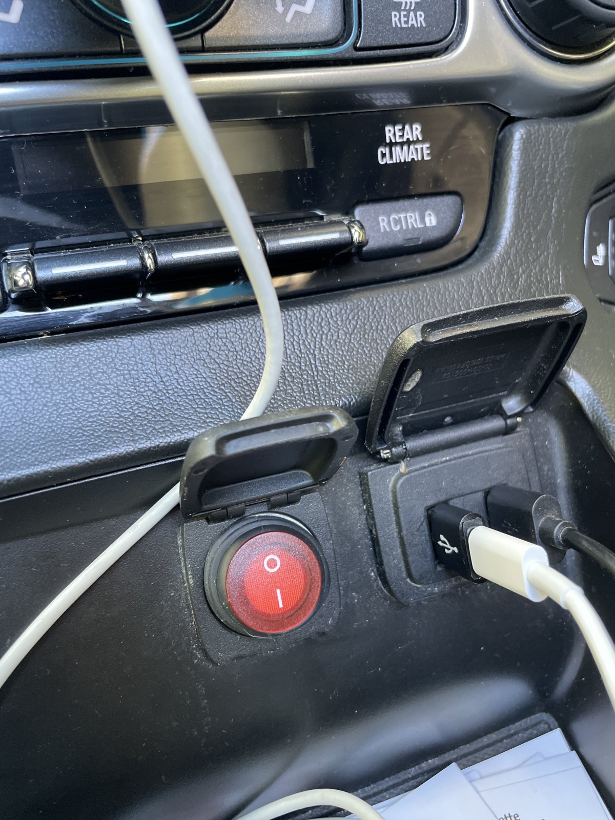

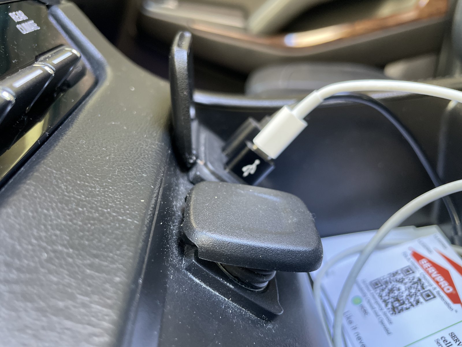

What were you doing with the console taken apart?
Unplugged back of 12v plug and smashed pieces from behind drilled out metal casing in the back fed wire through and switch housing fits perfectly inside the metal 12v cigarette plug. After spending 35min I was going to cut the damn thing because I wasn’t about to remove both fuse boxes to find the fuse, was able to unplug it instead. After watching videos of you remove the metal piece it holds the cover on the outside so left it in place and just used it as a placeholder for the switch. Hope that makes sense ?

It doesn’t close all the way but that’s okay with me I’m proud of what I accomplished and I did not break any tabs usually I break at least one lol

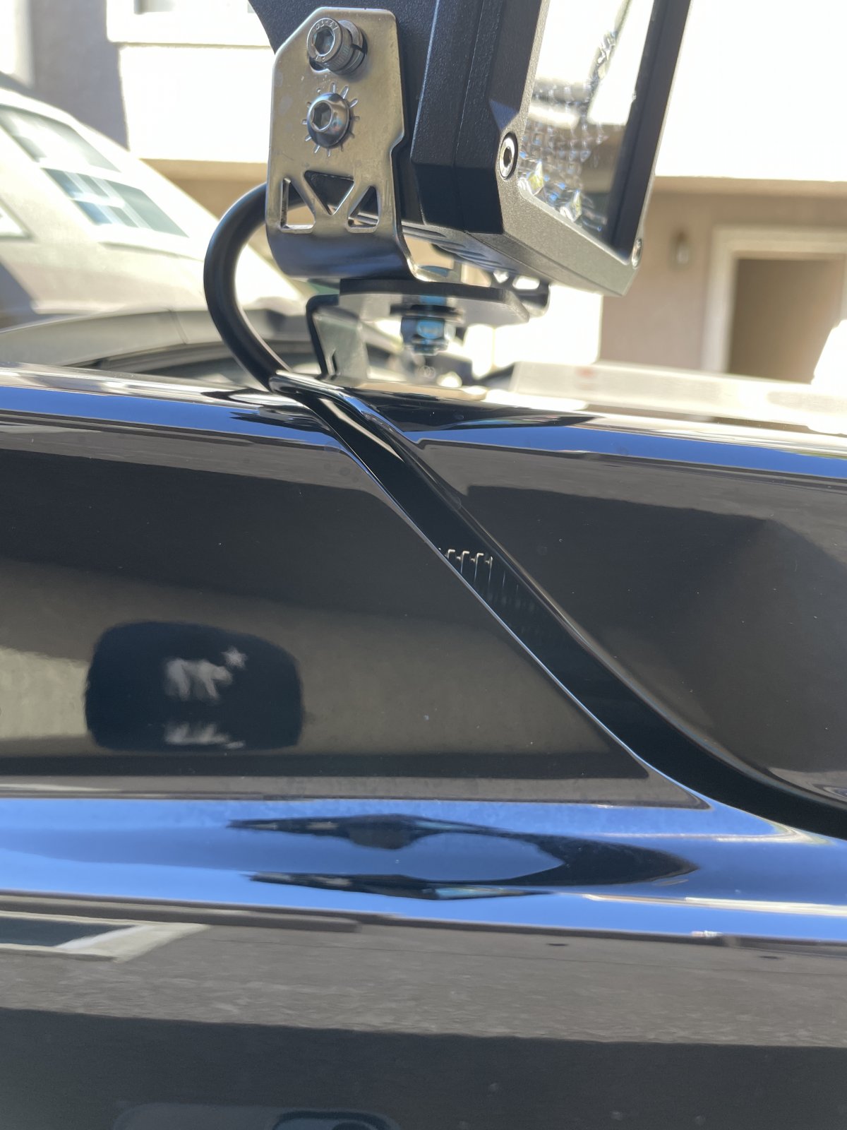

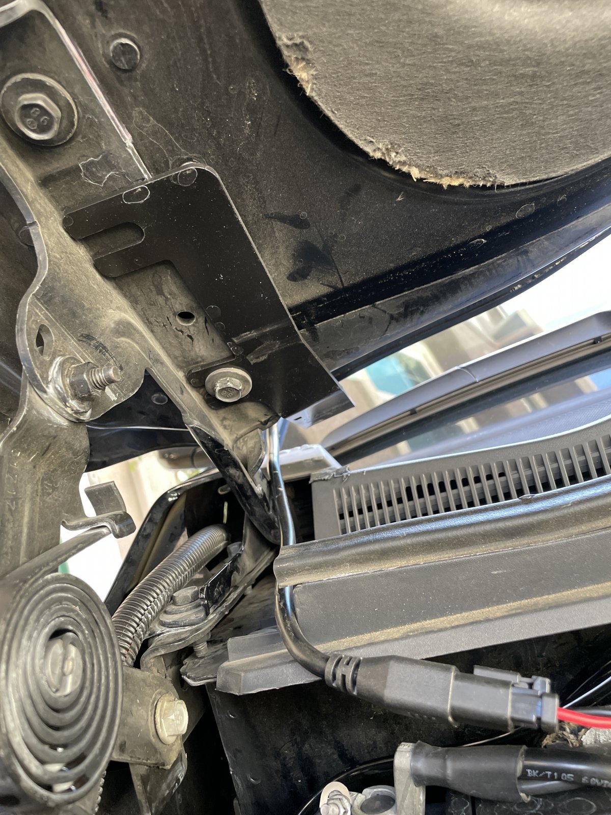

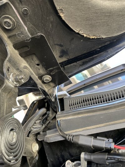

Only thing is bracket on passenger side makes hood not close flush forwards windshield in 3rs photo

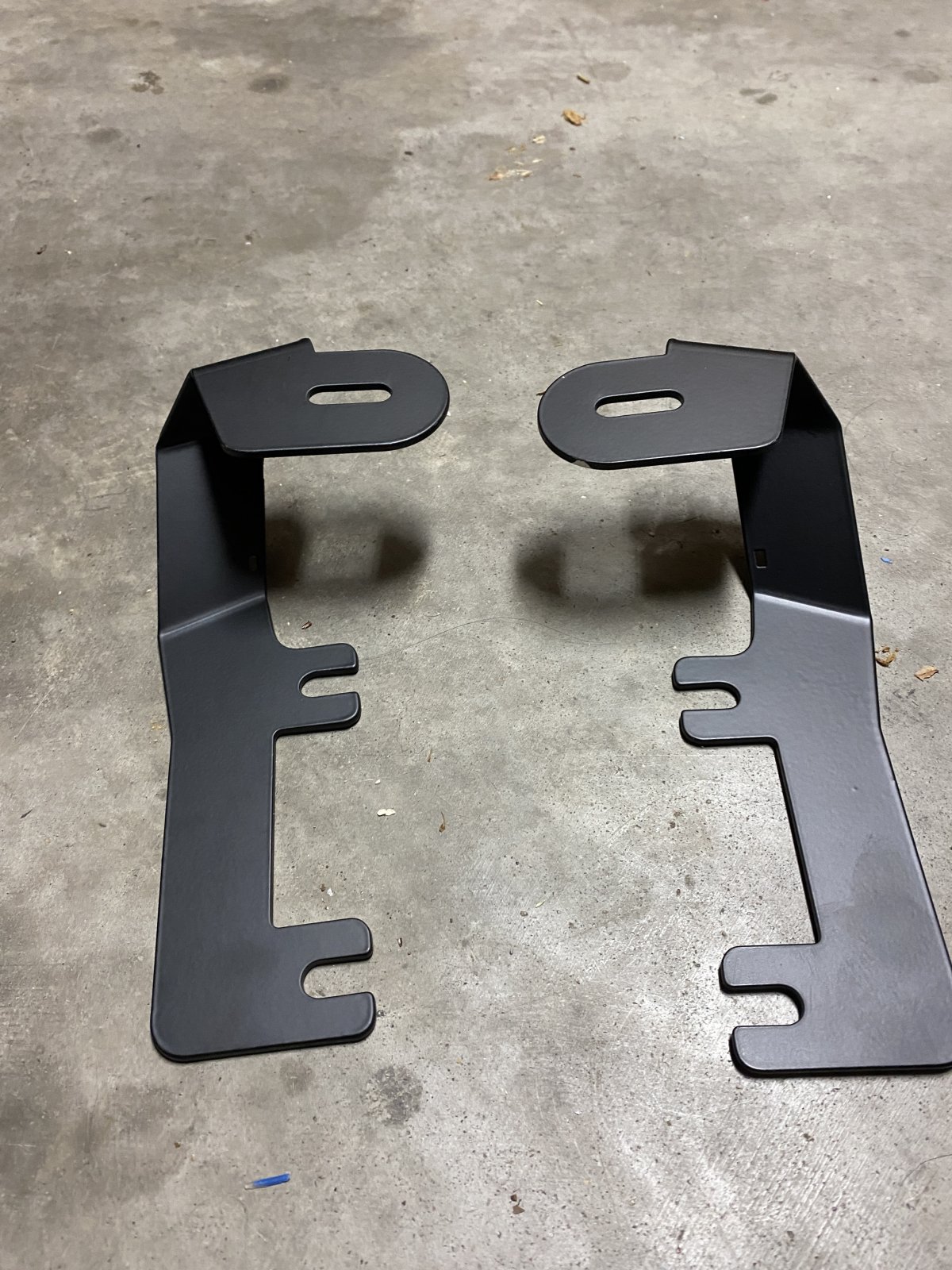

These brackets are supposed to be for Tahoe but only one mounts to hood screw as you can see in 4th photo. The brackets were $40 shipped. I found another type of brackets for $75 I’ll buy those next and hopefully fit better!!

Why not just mount the switch in the flat face next to the cigarette lighter?
How did you bring the wiring from the lights to the switch?
Ghost10
Ghost10
Feb 16, 2017
621
256
I did not want to drill any holes, through the passenger wheel panel, I have hot leads from battery going to a digital usb hub and the switch wire from the lights. Plenty of room. The only easily accessible port is on the floor board of the drivers side. Which wouldn’t work for me in fact won’t work at all since I have a street style SUV and don’t want wires under the carriage

I apologize for commenting on an old post, but would you be willing to share how you removed this section? I can’t find instructions anywhere. Thanks in advance!
It just snaps in. I found a youtube a while ago the shows it. You basically pull upward starting at the end away from the dash. Putting it back in is much easier if you remove the kick plate below the dash.
Ghost10
Ghost10
Feb 16, 2017
621
256
Gotta remove knee bolster on driver side!!!!
