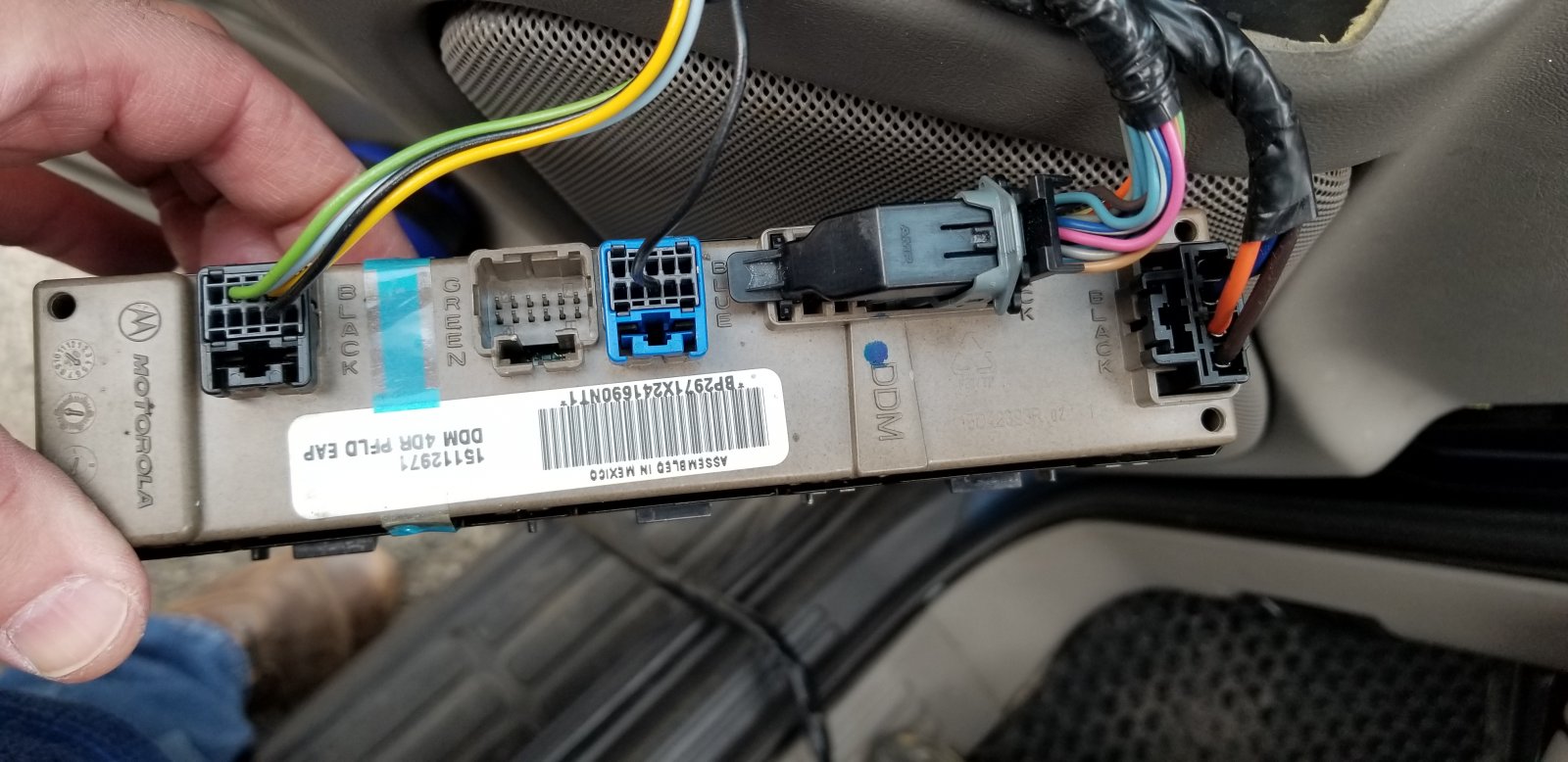

What a strangely optioned truck. I've never heard of a truck like yours not having power mirrors. Usually the cheap work vehicles don't have power anything--and you have power pedals. I'm curious--even tho it's commanded by the bcm, if you can add power/heated mirrors with the correct master switch. Everything would just plug n play I'd think, no extra power wires to run. 20190313_161845.jpg20190313_161920.jpg
I know it's a little different, but I added power fold to my 03 when it didn't have it. Works great too.
