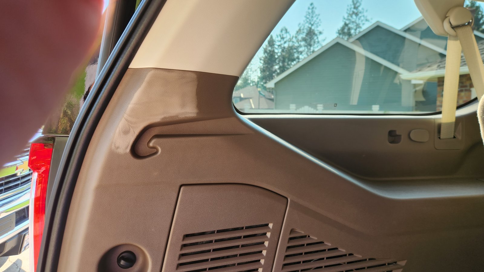

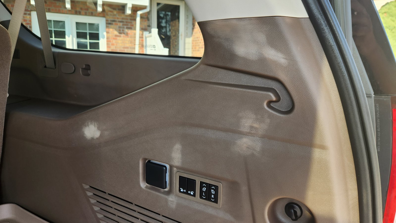

Looking for others that may be having the same problem I am having with discoloring/fading of the rear cargo panels on my 2023 Yukon XL Denali with Light Shale interior.
Noticed some slight discoloring when we purchased up the vehicle in April, and informed the dealer, at which time they ordered new panels. These new panels had the same problem, so were returned.
While waiting for the next set we noticed significant discoloring startin
g to occur (see pics).
Has anyone else had problems with discoloration? How did you remedy it?

Yeah, that's crazy. I'd bet anything that something was rubbed on (rubbing against) those spots.

Yeah I agree something caused those faded areas on the surface of your interior panels and it doesn't appear to be caused by the sun. If it were from the sun it would be a large gradual area of discoloration.
Those type of marks are small and isolated from either direct contact from something; a liquid chemical, an object rubbing against it while driving down the road.

I was going to say probably an abrasion, but zooming in the photos look like a bleach or dye, so I would agree it was a chemical.
You can always scuff up that area and spray it with that plastic spray bomb product. Just mark the surroundings area. Try to blend it or spray to the next edge so new color matches somewhat. It's in the trunk, so probably not too critical step on the blending.
I did a small repair to a rear door panel and front seat side plastic and turned out nicely, Duplicolor product.

It almost appears as though the coloring in the plastic didn't set right in the forming process. I say this because you can see swirls, streaks, etc thar shown up around and through the piece. I'm sure exposure to air and sunlight made it fade. Or, whatever color fasting they do and/or UV protection may have not mixed or cured properly

Manufacturer defect, at some point in the injection molding process the mix was not done properly. something didn't flow right or temperature in the processing was wrong, miscalibration, etc, might have passed initial inspection but shows up later, probably after exposure to heat or cold.
