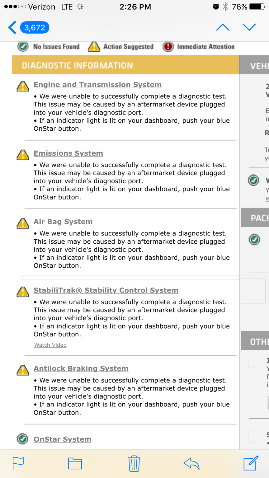

Same here, 24/7 plugged in and truck sits all week though, no probs, but then again i have 2 batts. I plugged it in april 1st i think and my onstar report comes on the 16th or 17th and this month it couldnt read anything and actually said an aftermarket device may be plugged in....

Interesting - what year and model are you driving. As mentioned, mine is a 2017 Yukon Denali purchased 2/22/17. I've had two OnStar reports (March and April) and neither one reported any OBD port interference. Wonder if Range and/or GM changed something. My Range is version 8.1
2013 tahoe and onstar report came this month, no issues.....range still plugged in i havent unplugged it since i bought it.
