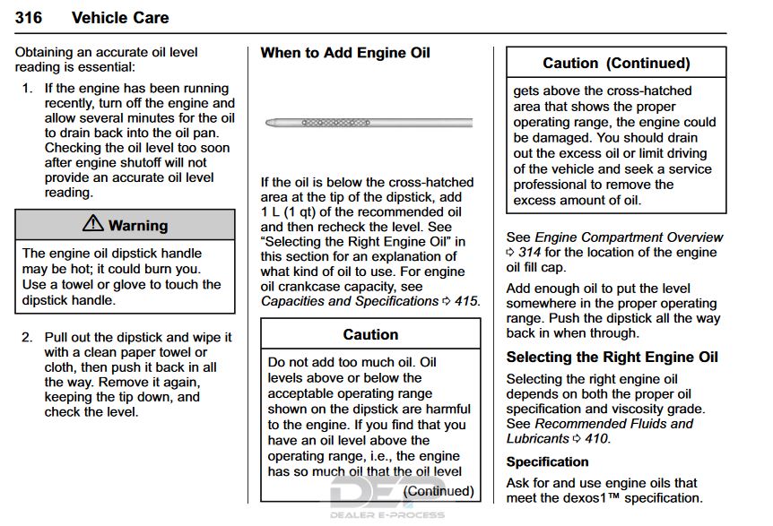

Here's what the 2016 manual shows. You didn't specify your vehicle so this is just a guess.

Owners manual says the same as what Fless posted. It doesn't specifify though if it should be at the upper dot or the top of the crossed hatched mark.

As per what the manual says, do not go higher than the top hole or top of hash mark with the oil level.

You don't want to go above the hash marks Chris and if you only fill to the bottom mark or two in the hashed marked area, that's ok too but leaves you with a little less room for error should the engine suddenly lose or consume oil. Probably get bit by a dog before that happens though. 8 quarts and drive on.
