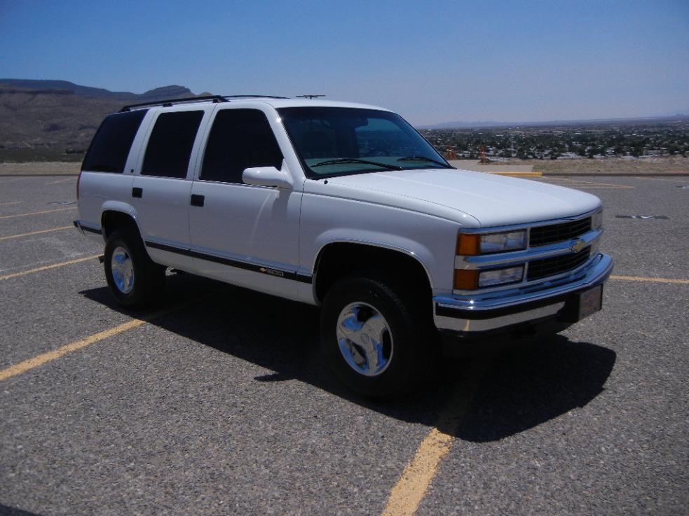

Here's my Tahoe overlooking the City of Alamogordo NM.
