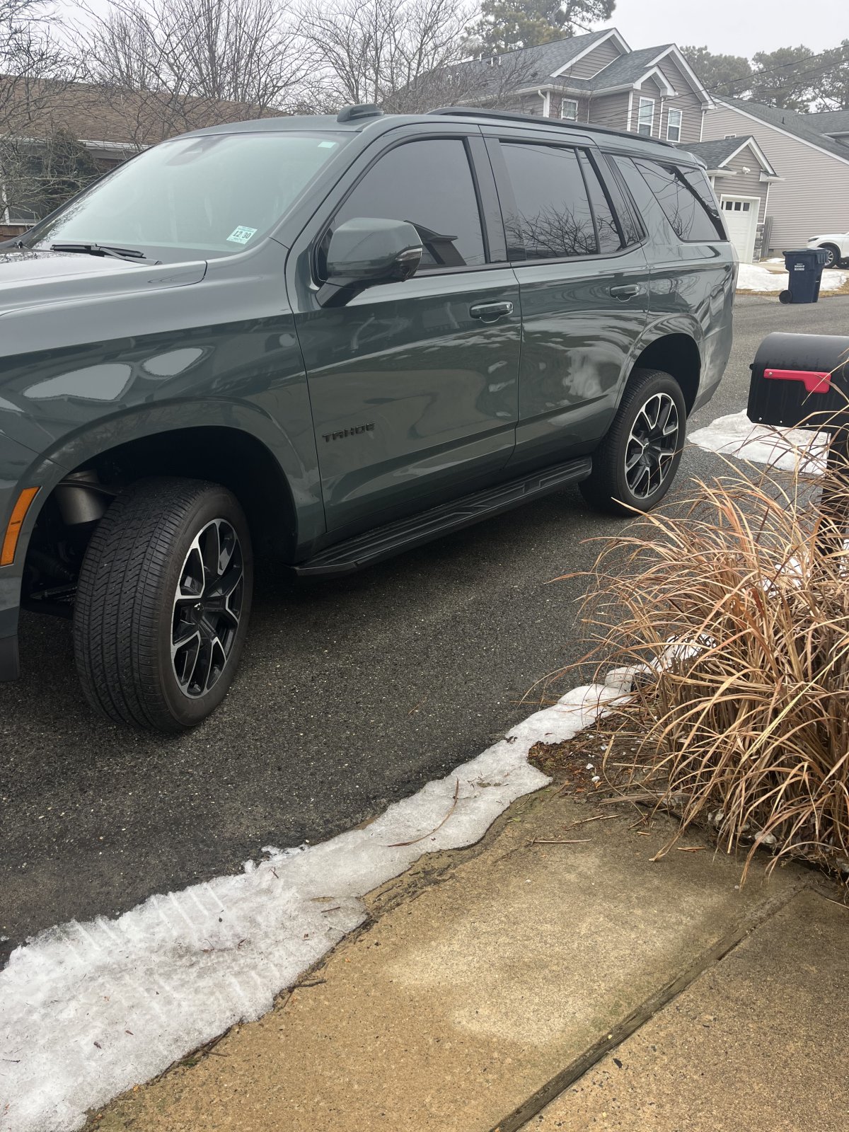

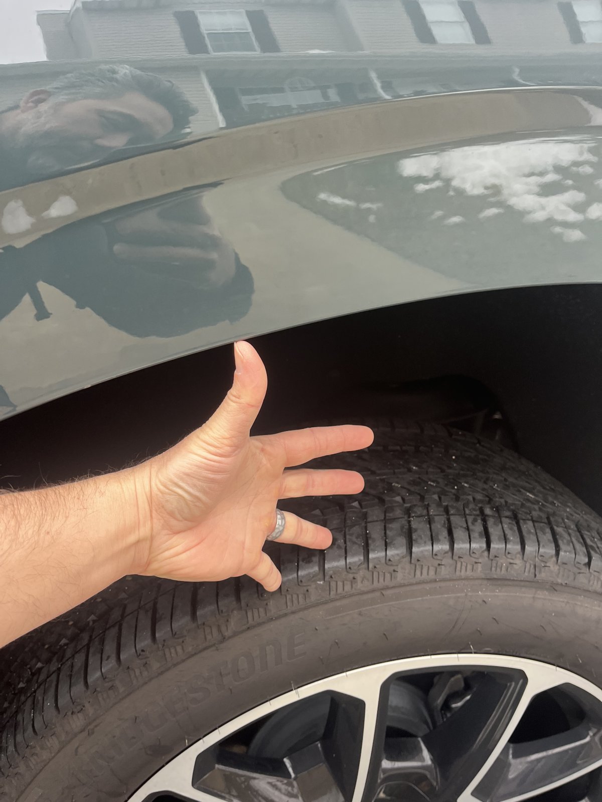

This is on max height, it’s pretty tall.
