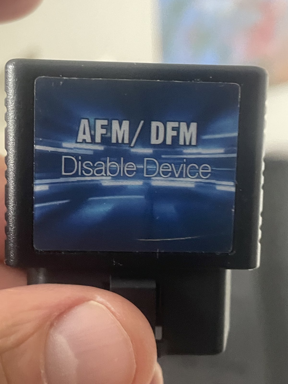

I googled it. Got it! Question: Will this device be adequate?

better than doing nothing. however.. it does allow the 5.3 to use DFM during coasting. bummer. i use carbyte. it works on deceleration too. and you can use 10th gear.
while you are working this... do implement a wash of the intakes with solvent... as the intake cokes up with what comes in from the intake.. this is what contributes to loosing a lifter. also install a catch can to eliminate a lot of oil on the intake valves... and think about using a 5w30 oil. the heavier oil does reduce how much comes oil off the intake...
Thank you!!

I’m going to buy the carbyte.

I bought the carbyte! I was just wandering why the Carbyte is better than the one pictured above. Just curious. Thank you!
