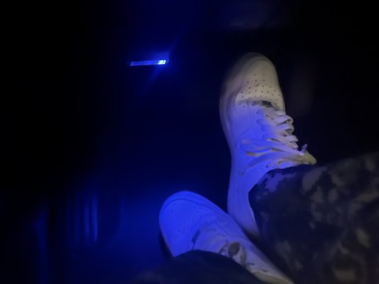

just for what it’s worth, i guess this is a good place to put this, but i have the range obdII unit, and the other night i was in the drive thru. I noticed the when i let off the brakes there was a more intense glow so i started paying attention, and when the brakes were applied and the vehicle was not moving there was only 1 led lit. When i let my foot off the brake, all led’s were lit.
Not sure if anyone else has noticed this. i guess this implies unit Is not active during idle (either because afm is not activated or other reasons)

I think maybe you’re in the wrong section. AFIK range does not make an OBD2 port device for the 21 and up models.
What year is your truck?

Yeah you are right on all accounts. . . my truck is a k2 , but tbh I just didn’t know where to put this and didn’t want to make a new thread to show off my feet lmao
I figured that the overall operation of the modules may be similar or the same to the t1’s, so it may lead some insight across the board.. i could be wrong considering afm and dfm are different so yeah this might be totally irrelevant
